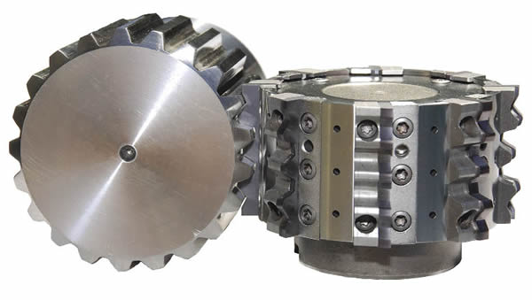

When a multiple-function tool is not a necessity, end users generally prefer to apply a tool created to perform one operation the best it can, according to Ross Wegryn-Jones, national sales manager for TMFM LLC, Lake Bluff, Ill., which focuses exclusively on making application-specific carbide spline and form milling tools. “Mainly what we push is just our tool as it is and rely on the toolchanger for the rest,” he said. “The drill/thread mill isn’t all that it’s cracked up to be, and people get upset when the tool life of the drill isn’t the same as the thread mill.”

Mills Made-to-Order
Courtesy of TMFM
A special spline mill engages the workpiece. TMFM custom made the inserts to match the form at hand.

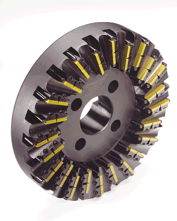

Mills Made-to-Order
Courtesy of Greenleaf
A 10 “-dia. application-specific plunge mill engineered by Greenleaf provides a 1.75 ” WOC.
