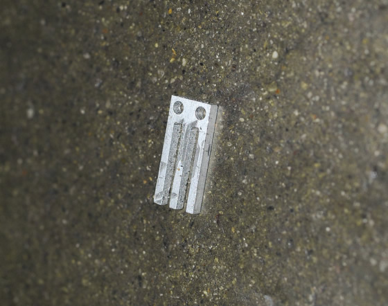

Before working with tiny parts, sweep the floor so a part can be easily found if dropped. All images courtesy T. Lipton.

- Sweep the floor before you work with really small parts and assemblies. Those tiny parts closely resemble chips and debris. I’m getting too old to crawl around on the floor so I had to get a little smarter. The precious part stands out in stark relief on a cleanly swept floor.
