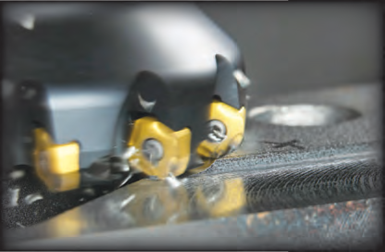

Recent developments in milling have the potential to save manufacturers substantial time and money by increasing throughput. From selecting the right milling cutter for the job to using a roll-in approach to facemilling and employing milling tools for holemaking when appropriate, manufacturers can improve milling productivity without investing a dime in new equipment.

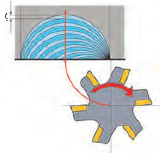

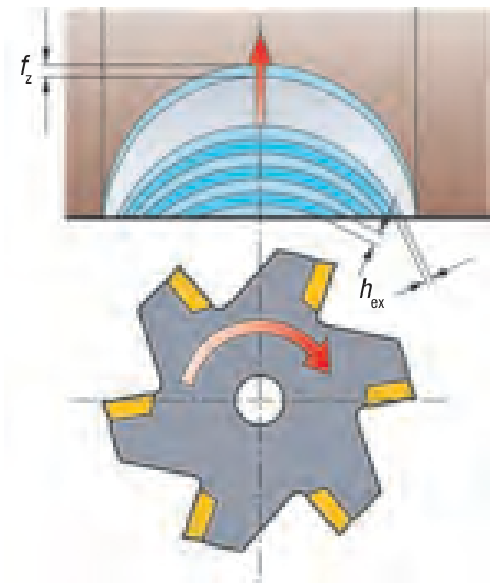

Another way to improve milling operations is through facemill optimization. When programming a facemilling operation, end users must first consider how the tool enters the cut. Typically, this is done by simply coming straight into the workpiece (Figure 1). Such a method is usually accompanied by a banging sound that results from the tool producing a thick chip when the insert exits the cut. The insert pounds against the material, introducing vibration and producing tensile stresses that reduce tool life.
MAOM
Figure 1. When facemilling, entering a cut straight on introduces vibration and produces tensile stresses that reduce tool life.
A better approach is a roll-in technique, where the mill rolls into the cut without reducing feed rates and cutting speeds (Figure 2). This involves rolling the cutter in a clockwise motion, ensuring that climb cutting takes place. This produces chips that start thick and end thin, minimizing vibration, reducing strain on the tool and increasing the amount of heat entering the chips. Tool life can double or triple by changing the way the tool enters each cut. The programmed radius of the toolpath to implement this technique is to use half the diameter of the tool and add the distance of the offset from the cutter to the workpiece.

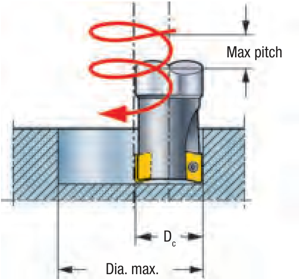

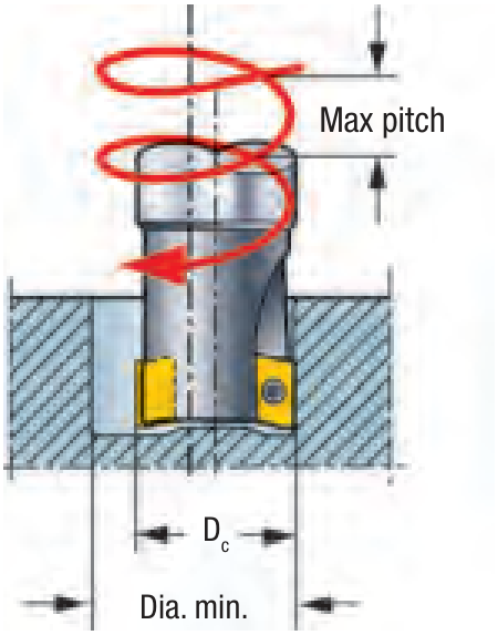

Tool size becomes especially important when using a milling tool for holemaking. If the diameter of the tool is too small for the diameter of the hole, the process can create a core of material at the hole’s center (Figure 4). When this core falls, it will damage the part or tool. A milling tool that is too large will damage itself and the workpiece, as the milling cutters are not center cutting and crash at the bottom of the tool (Figure 5).
MAOM 04
Figure 4. When using a mill for holemaking, employing too small of a mill results in a core at the hole’s center, which can damage the tool and part.
