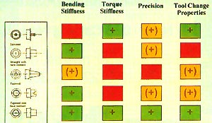

This chart rates the performance of the locking methods used by the modular toolholding systems currently on the market.By following these guidelines, users of modular toolholders and cutters can maximize their investment.

  • Consider modular toolholding. High-end systems are not limited in their application ranges. The best of today’s modular toolholding systems are as strong and accurate as the best of today’s conventional tooling. The table above compares the key performance features of the principal types of modular systems available today.
