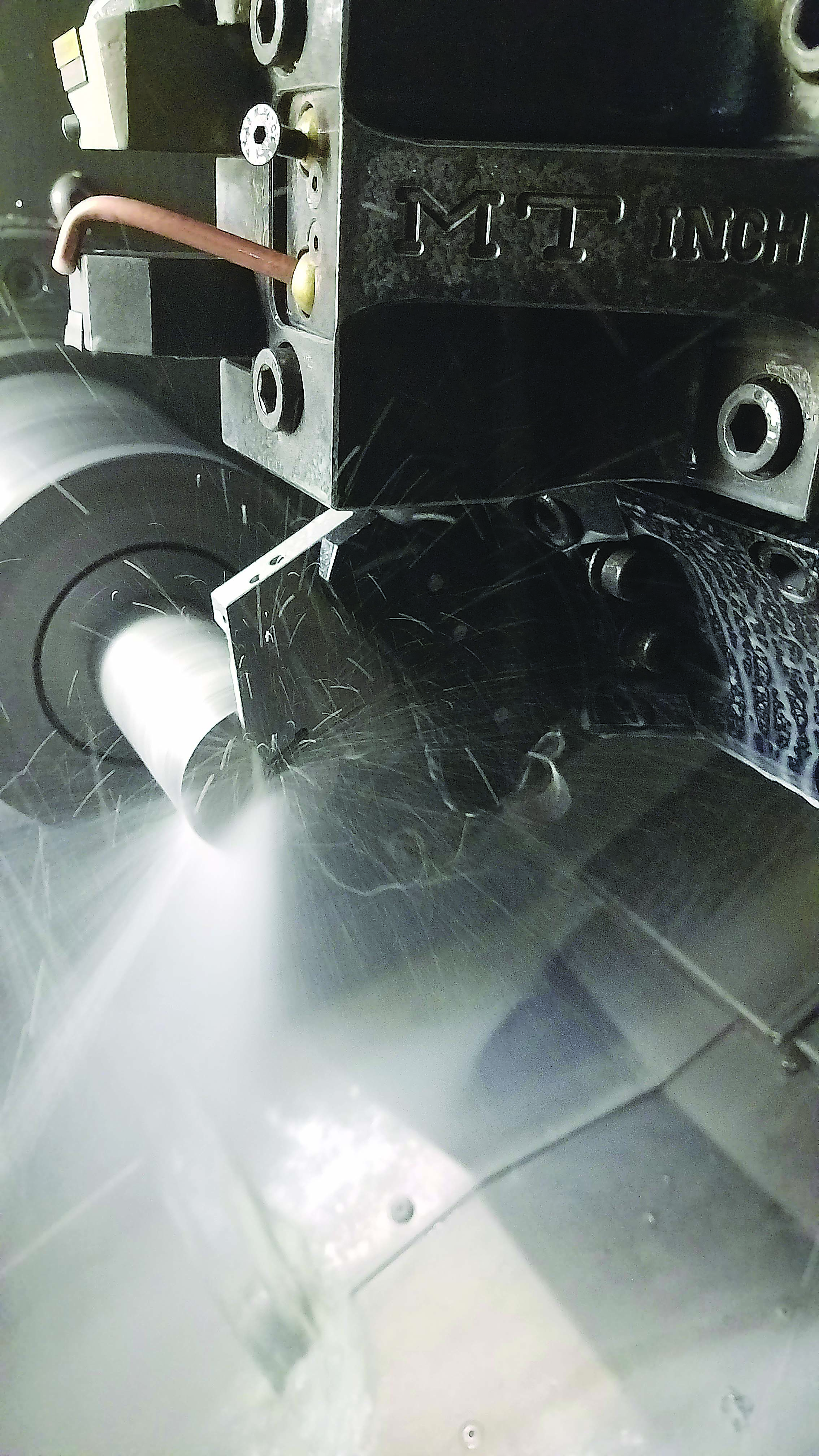

Premier Industries reduced cycle times, extended tool life and improved surface finishes when parting off after acquiring a modular toolholding system from Horn. Image courtesy of Horn USA.

He explained that on Premier’s machines, a toolholder typically mounts on the turret and a square-shank insert holder fits into that turret-mounted toolholder. Horn’s base holder, however, mounts to a turret, and the cassette system 845 mounts to the height-adjustable grooving tool cassette holder on the plate.
“You don’t have compression- or wedge-type fittings or anything like that to hold it together,” Haselbauer said. “Everything is bolted together, which really helps with rigidity. There are also a couple of alignment pins to make sure everything goes together square and straight.”
The modular grooving system 845 incorporates a baseplate that fits onto a turret via a base-mounted turret connection and is matched to the turret of the specific machine, Haselbauer added. According to Horn, the system also includes a height-adjustable grooving toolholder with an integrated coolant supply, a replaceable matching cartridge for various grooving widths and depths, and a grooving insert. The WOC range is from 1.2mm (0.047″) to 4.0mm (0.157″), and the DOC range is from 17.0mm (0.669″) to 55.0mm (2.165″). The system can part off material up to 110mm (4.330″) in diameter.

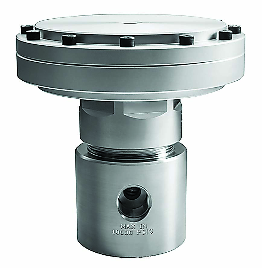

Premier Industries manufactures pressure regulators, such as this one, for a variety of industries. Image courtesy of Premier Industries.
Haselbauer added that because pressure regulators can be assembled faster than the parts can be machined, the shorter cycle time—combined with the reduction in machine stoppages to replace worn tools—means assemblers receive more parts per batch than previously. This increase in batch sizes enhances the efficiency of their assembly operations.
