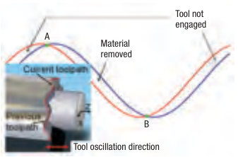

Researchers at UNC Charlotte (including the author) and at the U.S. Department of Energy’s Y-12 National Security Complex have recently shown a new way to ensure chip breaking when turning. In NC machines, the toolpath can be modulated along the feed direction to cause interrupted cuts and ensure chip breaking. Although interrupted cuts are usually not desired, that’s not the case here because the interruption is in the material to be removed later and not on the surface of interest. Essentially, a sinusoidal motion is superimposed on top of the nominal toolpath (Figure 2).
Because the oscillating motion is created using the machine axes, the oscillatory motion can follow the workpiece surface and be used for any turned surface geometry, including faces, profiles, tapers, spherical surfaces and internal and external surfaces. The frequency and amplitude of the oscillating motion are selectable parameters, but the frequency of motion required is generally small—on the order of a few cycles per second.

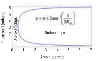

If the amplitude of the oscillation is too small, or if the timing is such that the waviness created on one rotation lines up with the wave created on a previous rotation, then the chip will be continuous and not broken. Figure 3 shows the conditions under which broken chips form.
In Figure 3, the vertical axis is the alignment between the current oscillation and the oscillation one revolution back (imprinted on the surface). Zero corresponds to perfect alignment as does 2π (a little more than 6), while π (a little more than 3) corresponds to a peak aligned with a valley. The horizontal axis is the ratio of the amplitude of the motion to the feed per revolution. The chips break when the amplitude of the oscillation is greater than half of the feed per revolution and when the current and prior oscillations are not well aligned.

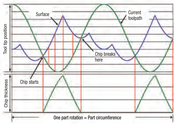

Figure 1 shows the surface created by a number of overlapping oscillating tool motions (blue line), and the current motion of the tool (green line). When the green line is above the blue line, the tool is cutting air. When the green line is below the blue line, the tool is cutting metal and forming chips. Chip length and thickness are shown in the lower portion of the figure.
It is interesting that through amplitude selection and oscillation frequency, chip length can even be programmed. Because the oscillation is tangent to the desired surface, the chip breaking waviness appears in material that is later removed. The remaining surface is often quite good, and the oscillating tool motion can even act like a wiper, taking the peaks off of the cusps of the feed marks.
