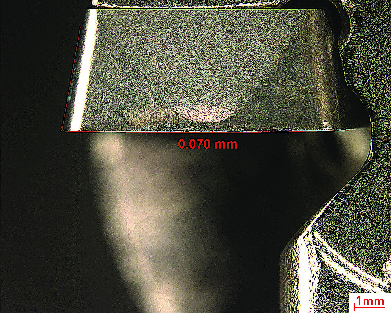

Good spraying behavior for an MQL system.
Figure 1. Good spraying behavior for an MQL system.
All metalworking fluid-related lubrication approaches, including MQL, have a common characteristic: continuous targeted feeding of fluid into the cutting zone. The fluid must be delivered accurately onto the rake angle and flank face of the cutting tool to deliver optimal results, which can best be achieved by means of an internal metalworking fluid supply.

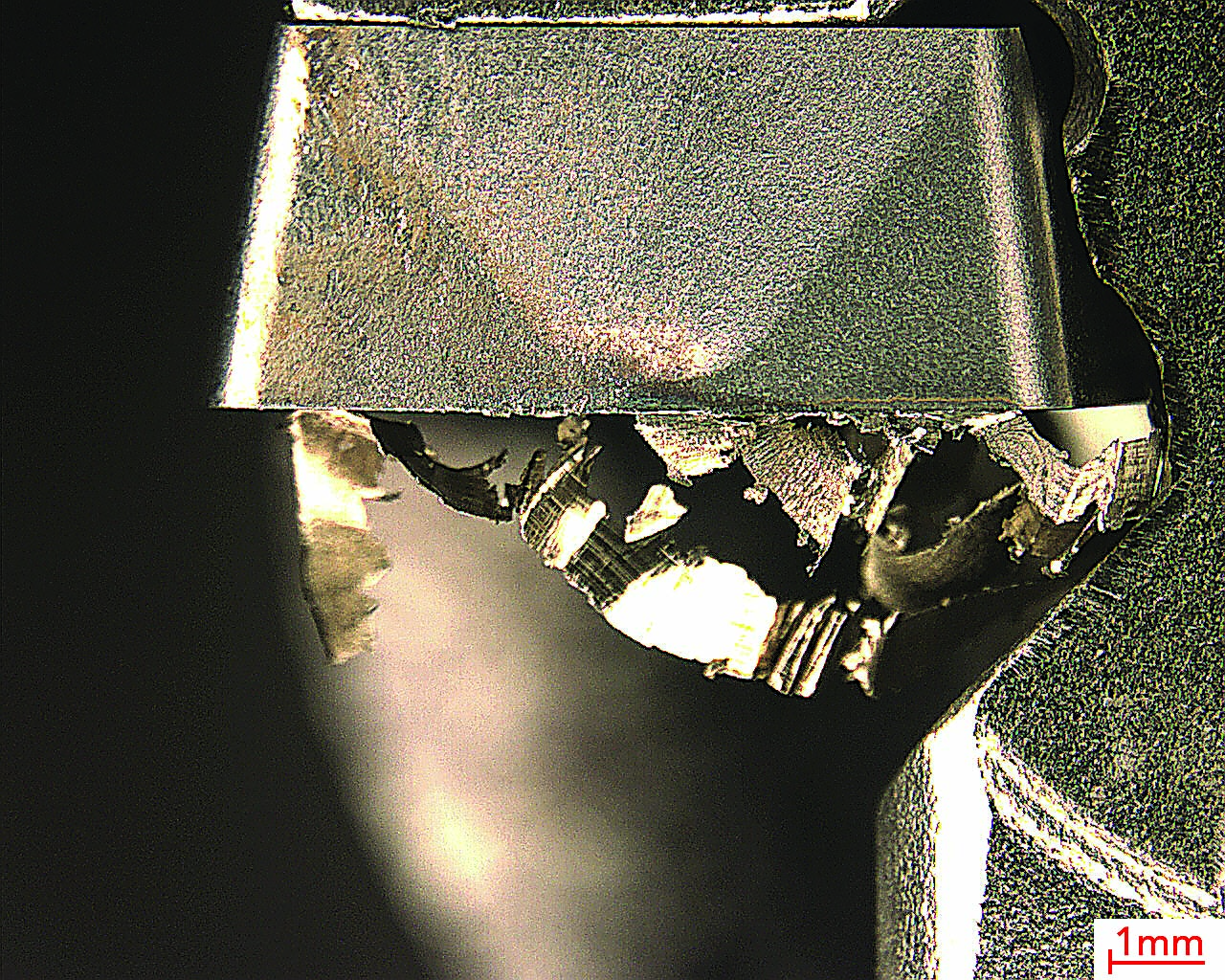

MQL effectively prevents built-up edge compared with dry machining.The optimal combination of MQL oil and tooling increases productivity and lengthens tool life.
Figure 2. MQL effectively prevents built-up edge (this page) compared with dry machining.

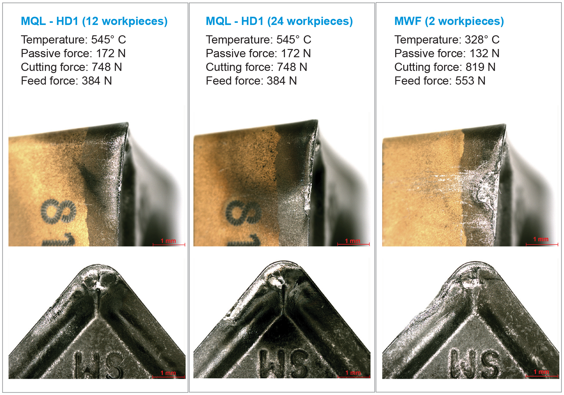

MQL machining in the case of 12 or 24 workpieces versus wet machining two workpieces when turning 304L stainless steel with a low nickel content.
Figure 3. MQL machining in the case of 12 or 24 workpieces versus wet machining two workpieces when turning 304L stainless steel with a low nickel content.
During the test, the MQL product Vascomill MMS FA2 showed impressive performance and helped increase tool life by 243 percent. The product also enabled the feed rate and the cutting speed to be increased, contributing to a total productivity increase of more than 70 percent. The cutting speed went from 426 sfm to 1,279 sfm. Furthermore, the optimal MQL strategy prevented built-up edge on the cutting edge (Figure 2).

In the field of turbocharger production, in collaboration with a global market leader, tool life increased by a factor of up to 12 when using MQL compared with conventional metalworking fluids (Figure 3). This is because the brittle and hard carbide indexable inserts react to the change in temperature during wet machining, also known as thermal shock. Furthermore, conventional coolant machining requires ductile inserts and coatings.
