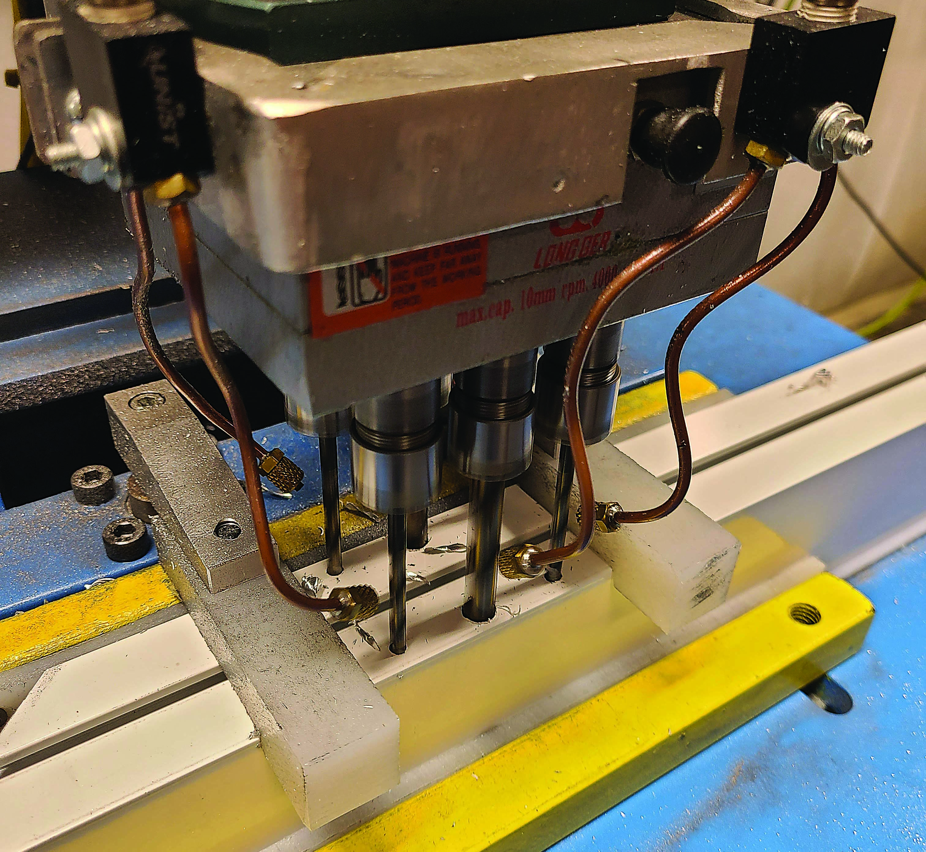

About four years ago, PCA Products started to build computer-controlled cutting tools and added Unist applicators that could be triggered from a programmable logic controller or from software, he said. In addition, the company put MQL systems on equipment that it initially didn’t consider suitable for a Unist oiler, such as two- and six-gang drill heads, chop saws, flywheel presses and a pneumatic punch. When equipment is oiled manually, PCA Products has developed methods to prompt the Unist oiler.
“If we are using a pneumatic tool or a chop saw that only has air to it but no power,” Yates said, “we will use a pneumatic roller switch and just trigger the Unist (oiler) from the pneumatic trigger.”

The six-gang drill at PCA Products is equipped with a Unist MQL system with three pumps that are PLC-triggered to three split nozzles. Image courtesy of PCA Products

Yates said PCA Products uses the same base MQL applicator with usually either a single-pump oil unit or a dual pump for machines with multiple nozzles.

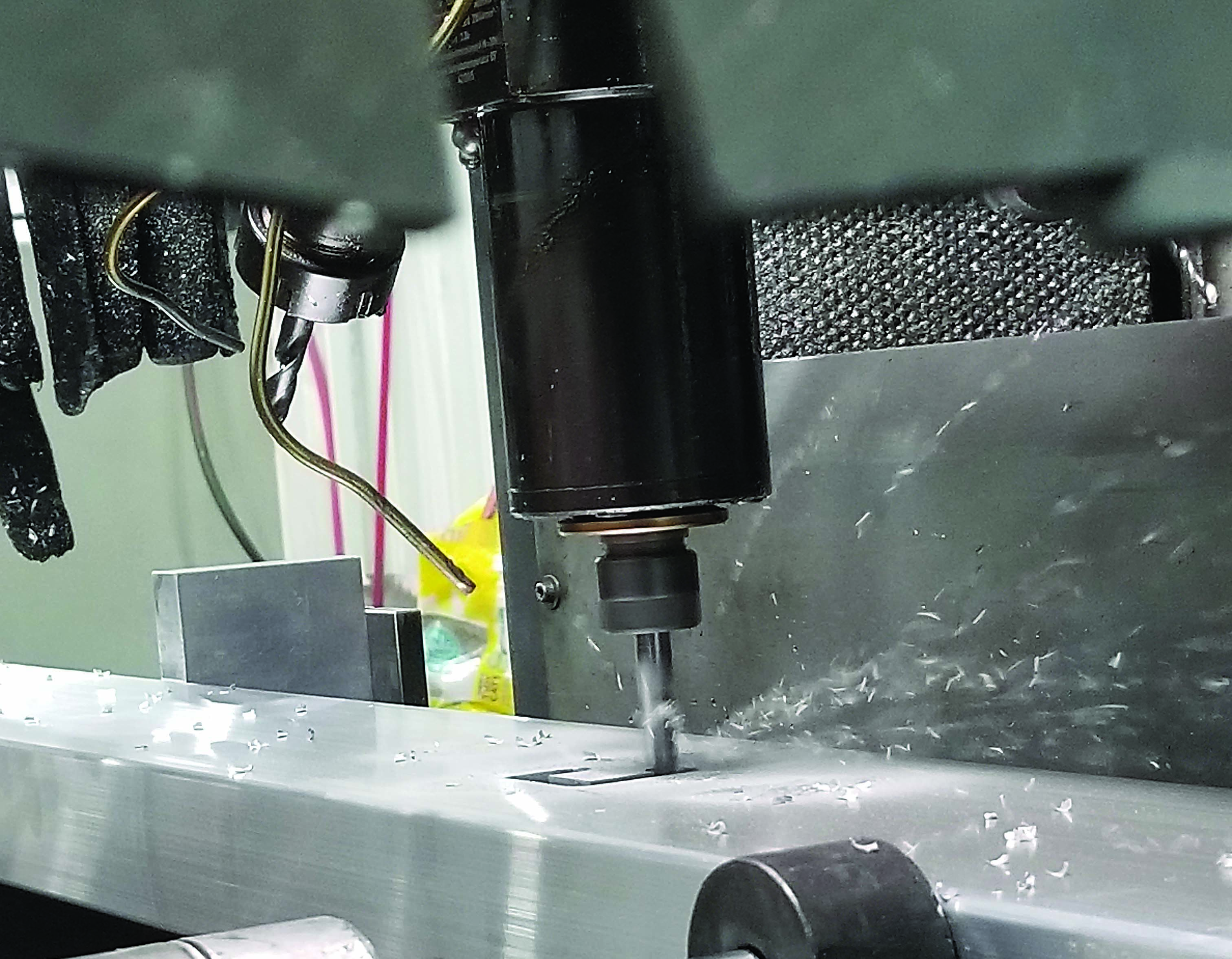

“We use a triple pump on the six-gang drill to get all six nozzles lubricated,” he said. “We use split nozzles on the drills, drill presses and punches. It allows us to get two nozzles out of a single pump.”
With MQL, a tool remains dry enough to blow chips off it with an air hose, Yates said. In addition, tool life nearly has doubled compared with manual spraying, depending on the application. For example, a drill on a six-gang drill unit now produces 2,000 to 3,000 holes before needing replacement.

He estimates that the company also has seen a cycle time reduction of at least 10% because of increased repeatability and the elimination of the need for an operator to take time to spray a tool and pause an operation to refill a bottle.

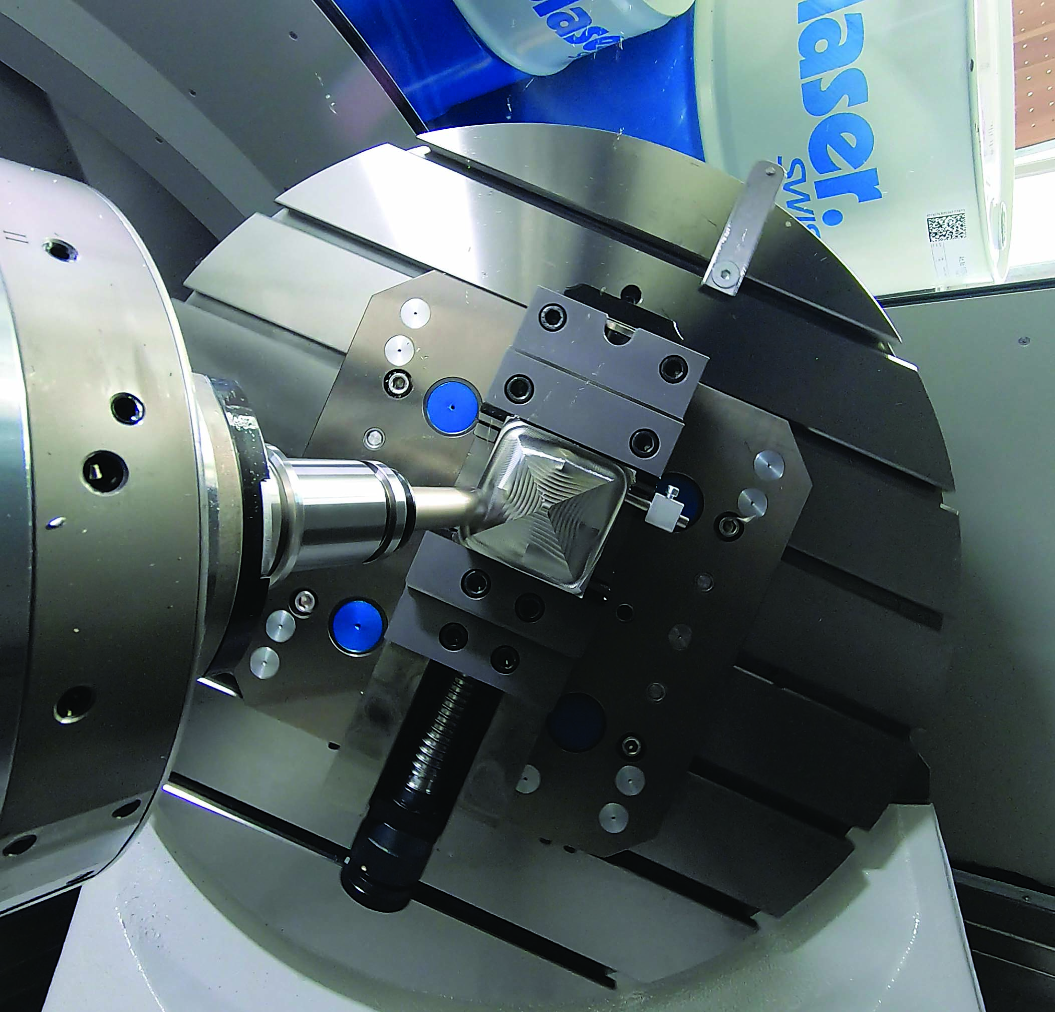

Blaser Swisslube offers Vascomill lubricants for a variety of MQL machining operations, including milling. Image courtesy of Blaser Swisslube

Elite Trailer Manufacturing selected Blaser Swisslube’s Vascomill MMS SE2, an ester oil-based lubricant.
“As soon as we started running that in the machines,” Lindsay said, “there was no further damage to any of the wiring — or anything at all.”
In addition, he said the lubricant doesn’t dry sticky, so operators can clean machines while they run rather than wait until the end of a shift. Also, the fluid residue doesn’t irritate skin.

“If there is not enough lubricant on there, the part starts vibrating,” Lindsay said. “You can hear the difference when cutting.”
