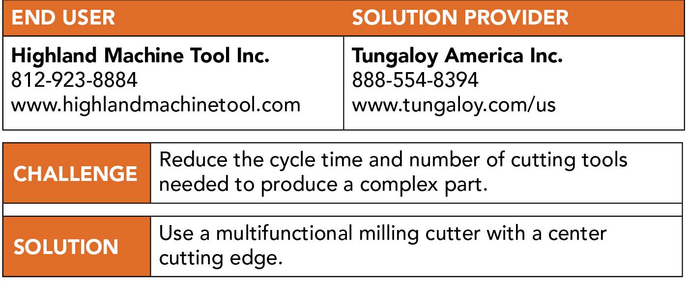

Tungaloy helps shop reduce cycle time and number of cutting tools needed for complex part build.

It doesn’t take a rocket scientist to realize that a change is needed when machining a part that has a long cycle time while the tool chatters and creates annoying noise.
That was the case at Highland Machine Tool Inc. in Floyds Knobs, Indiana, when machining an adjustment sleeve made of 1018 medium-carbon steel. The cycle time on a vertical machining center was 14 minutes at a cutting speed of 144.8 m/min. (475 sfm), a spindle speed of 2,304 rpm, a feed rate of 0.0254 mm/tooth (0.001 ipt) and a table feed of 175.5 mm/min. (6.91 ipm), according to a test report from Arlington Heights, Illinois-based Tungaloy America Inc., which supplied the milling cutter to solve the challenge.
“It was chattering the old way,” said Brian Sawicki, business development manager for the Northeast at Tungaloy America. “Everybody was complaining in the shop. That machine was loud as heck.”
He said the 38.1 mm-dia. (1.5″) workpiece starts on a lathe, where a 25.4 mm-dia. (1″) hole is drilled through the center. Previously, holes were drilled through the part wall in four positions after moving it to the VMC, which has a c-axis.

“There were two tools,” Sawicki said, “and they replaced it with one: the DoMultiRec.”
“We used to have to drill the holes for the old endmill,” Bender said. “With this tool, we can do everything. It gets rid of any type of tool change.”
In addition to milling and drilling, Tungaloy America reports that the DoMultiRec is suitable for ramping, pocketing, profiling, slotting, plunging, counterboring and helical interpolation.
By switching to the DoMultiRec, Sawicki said the shop reduced cycle time to 3 minutes, 45 seconds. The cutting speed increased to 182.9 m/min. (600 sfm), the spindle speed increased to 2,910 rpm, the feed rate increased to 0.0838 mm/tooth (0.0033 ipt), and the table feed increased to 487.9 mm/min. (19.21 ipm). As a result, the metal removal rate went from 11,143.2 mm3/min. (0.68 in.3/min.) to 30,971.6 mm3/min. (1.89 in.3/min.).
Tungaloy America calculated a total cost reduction of $24,535 for a batch of 800 parts.
