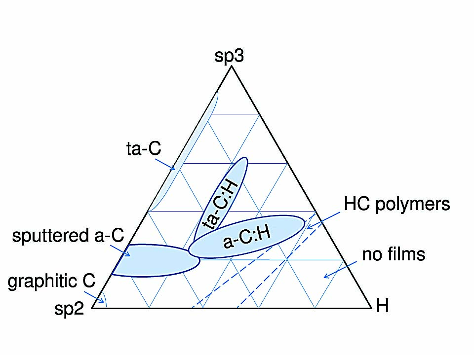

The coatings are usually classified by the ratio of sp3 to sp2 bonds and the hydrogen content. When carbon is sp3-bonded, it will form diamond; sp2 bonds will lead to graphite. With an increase in the ratio of sp3 to sp2 bonds, the hardness of the coating will typically increase.

Classification of the family of DLC coatings based on the amount of sp3 (diamond bonds) and hydrogen content.
