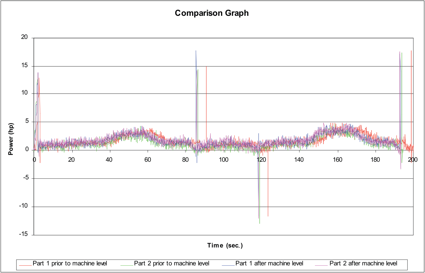

A newly rebuilt grinding machine was able to run flat components to specification. However, when grinding a component with a profile or form, the machine could not hold the required form tolerances due to wheel breakdown. Spindle power and vibration data were recorded and analyzed.
Courtesy of Saint-Gobain Abrasives
Figure 1. Dressing diamond roll power curve. The pattern shows little part variation.
Vibration was suspected as the source of the problem. A vibration data acquisition tool and a grind-cycle power monitor gathered data. These tools provided information on the dressing system and the grinding wheel drive spindle. (Details regarding the benchmarking and dressing cycle modification can be found in the online version of this article).
A full cycle of vibration information was taken during the grind of both flat and profiled components. The vibration analysis output curves were similar, indicating process consistency. However, slightly higher amplitudes were seen while grinding the profiled part. The highest recorded amplitude was 0.1 “. While this appears to be high, it was likely caused by mounting the sensor outside of the cantilevered guarding. The curve in Figure 1 shows the power cycle for the process.
Power and vibration analysis revealed no significant problems. It was then decided to check the machine level and reverse the direction of the dress roll from negative to positive to open the wheel.
Upon inspection, the machine was not even close to being level. Nothing registered on the precision level in either the X or Z axes. It was later determined the machine rebuilder assumed the user would level it.
After the machine was leveled, the grinding process and slot feature tolerances improved. The slot was inspected with an optical comparator and corner rounding of the slot was no longer an issue. Leveling this machine allowed precision profiling and flat grinding.
In all three cases, machine unlevel was the biggest cause of grinding problems. It affected surface finish, form holding and part geometry and caused chatter. This, in turn, negatively impacted tool life, cycle time, quality, amount of rework and, ultimately, operating cost. CTE
