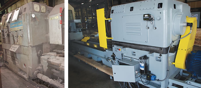

Left: A worn-out, manually operated lathe that Texas Machine-Tool International remanufactured, which included adding ground ballscrews and low-backlash planetary gearboxes coupled to an A/C servo system. Images courtesy Texas Machine-Tool International.
The remanufacturing process can produce a machine that’s actually better than when the machine was new, claimed Michael Sullivan, president of Texas Machine-Tool International LLC (TMI), a machine remanufacturer and rebuilder in Waco, Texas. “There are a lot of enhancements that we can offer a customer that go beyond restoring [a machine tool] to its original condition,” he said. These include converting a manual machine to CNC and adding pressure-monitoring load cells, as well as revamping machine axes so that they exceed the original OEM specifications.

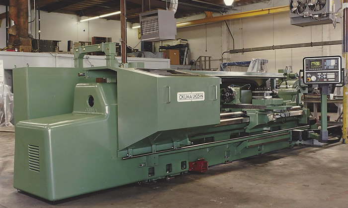

This machine looks as good as new after a rebuild by Orange Coast Rebuilding. The process included upgrading the control, regrinding the ballscrews and hand scraping mating components. Image courtesy Orange Coast Rebuilding.
At TMI, remanufacturing involves completely disassembling a machine down to its frame, which is steam-cleaned and inspected for cracks and other damage. In addition, components such as ballscrews, thrust bearings and wiring are replaced, as is the lubrication system, if it’s deemed inadequate for an up-to-date machine. Old components that remain are individually painted before the machine is reassembled.
Another important part of the process is restoration of the ways. OCR works on the ways until they meet or exceed the original factory tolerances. The key: “We do a tremendous amount of hand scraping,” Remick said. “We probably have more hand scrapers than anybody west of the Mississippi.”
OCR’s rebuild process also includes the addition of state-of-the-art controls. When all the work is finished, the customer comes to OCR’s facility and runs some parts on the rebuilt machine to test it. Then the machine is returned to the customer’s facility, where it’s set up and leveled by OCR personnel.
Remick said a rebuild typically takes from 8 weeks to 3 months. Sullivan said TMI rebuilds can take anywhere from 12 weeks for smaller machines to 26 weeks for large units. Along with a rebuilt machine, TMI customers get a report containing laser measurements of the straightness, flatness, pitch, roll and yaw of the machine’s axes.
