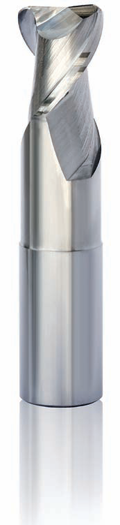

An uncoated 2-flute endmill from Gorilla Tools enabled D&G Precision Manufacturing to significantly increase the feed rate and tool life compared to a previously applied uncoated 3-flute tool.

Next, Potocki discussed the milling operations with Mark Greenwood, national sales manager for Gorilla Tools, to determine how D&G could reduce cycle times for the 3-flute endmills it was running. “He said, ‘we’ve got a new 2-fluter that we’re in the process of fine-tuning. How do you feel about running it? It should handle the chip evacuation and decrease cycle times,’ ” Potocki said, noting that the uncoated 2-flute tool has a larger flute space than the uncoated 3-flute tool. “Obviously, I’m in business to make parts faster.”
Lloyd Cribb, D&G’s programmer, reprogrammed the milling operations to take full advantage of the new tools, and the company ordered two sets of four diameters: 1⁄8 “, 7⁄16 “, ½ ” and ¾ “. Compared to the 3-flute endmills, D&G was able to significantly increase the feed rate. The feed went from 45 to 80 ipm for the 1⁄8 ” tool, 45 to 120 ipm for the 7⁄16 ” and ½ ” endmills and 80 to 100 ipm for the ¾ ” tool.
D&G runs all the endmills at the machine’s maximum spindle speed of 10,000 rpm. “We don’t have enough spindle speed to drive the tools as fast as we could,” Potocki said, adding that if the project becomes a long-term job the shop may acquire spindle speeders to achieve 30,000 rpm for the smaller tools. “When you hear the tools run, you just know they can take a lot more than what we’re doing.”
In addition to running faster, tool life increased more than six times compared to the previous tools. After producing about 6,500 parts, D&G changed its first set of tools. In contrast, D&G changed the original tools after producing about 1,000 pieces. At the Wisconsin Machine Tool Show in October, Potocki met Greenwood, who asked how the project was going. “Because we hadn’t ordered any additional tools at that time, his concern was that the project failed,” he said.
