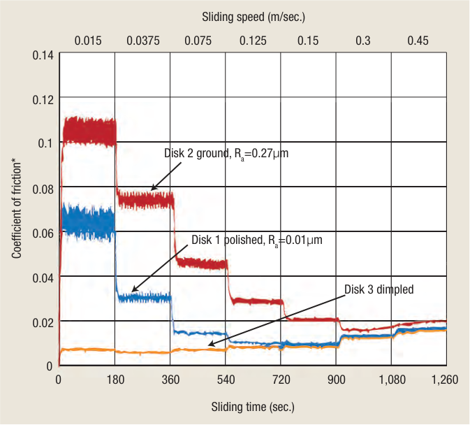

Courtesy of A. Erdemir. Argonne National Laboratory
Figure 1. Frictional performance of ground, highly polished and laser-dimpled steel surfaces in 15W30 oil at room temperature at various sliding velocities. *The coefficient of friction (μ) between two solid surfaces is defined as the ratio of the tangential force (F) required to produce sliding divided by the normal force (N) between the surfaces (μ = F /N).
Figure 1 illustrates the friction coefficients of ground, polished and laser-dimpled steel samples in sliding applications. Figure 2 shows a plane view and a cross-sectional plot of laser-dimpled steel.

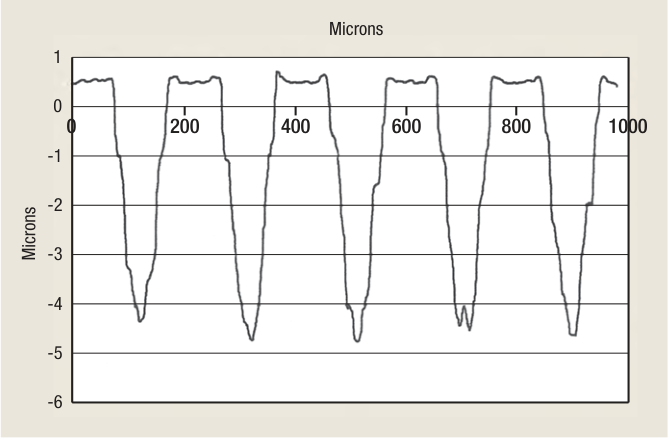

Courtesy of Argonne National Laboratory
Figure 2: Plane view and cross-sectional plot of laser-dimpled steel. Chart shows depths of dimples and longitudinal direction (not to scale with depth).
In one application, automotive engine cylinder-head laser dimpling produced 40µm-wide and 8µm-deep pockets spaced 600µm apart to capture oil for lubricating the piston at top dead center. The regular surface surrounding the dimples typically measures 1µm Ra.

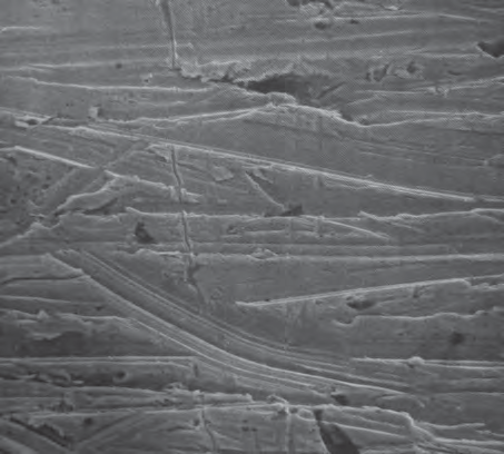

Brush honing has been used for decades to finish automobile cylinders (Figure 3). The process uses abrasive ball-ended brushes such as those manufactured by Brush Research Manufacturing Co. Inc., Los Angeles, to produce a uniform, crosshatched pattern that holds oil better than surfaces produced using other finishing methods, according to several U.S. and Japanese automotive studies. This increases compression and lowers engine wear.

Courtesy of Brush Research Manufacturing
Figure 3. Results from Flex-Honing ground intake valve stems with 240-grit, boron-carbide tool for 1 minute, shown at 1,000× magnification.

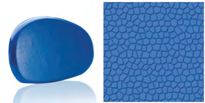

Courtesy of Ikonics
Pattern (right) applied to a mold using the DTX process for making a plastic seat back cover (left). Similar patterns are applied to molds for automotive dashboards and seat covers.
Acid etching goes digital
Ikonics Corp., Duluth, Minn., has developed a digital process for acid etching steel molds. In the Digital Texturing Process (DTX), a DTXJet inkjet-style printer applies an acid-resist fluid on a transfer substrate. The flexible transfer substrate is a coated film developed by Ikonics that accepts the fluid. The self-adhesive transfer film with the printed pattern is applied to the steel mold before it is acid etched. Since it is flexible, the transfer film can follow the contours of the mold, including complex curves, corners, recesses and protrusions. This process reduces the challenge of registration, particularly with multilevel textures, according to the company.
The digital photoresist texturing technology improves acid-etching performance in applications where fine-line definition is challenging using conventional but inherently imprecise wax methods, according to Ikonics. The process can also improve cycle time. Since textured films are produced using digital artwork, files may be altered, edited or reproduced. Files can be digitally stored and encryption-protected.
