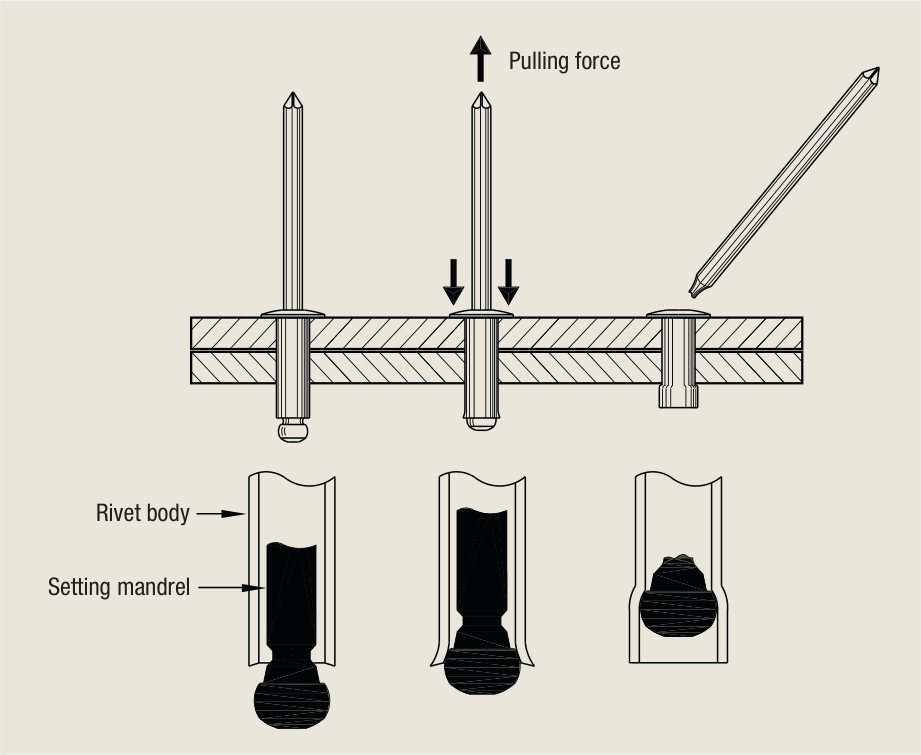

The blind rivet joining process.
A blind rivet consists of two parts: the rivet body and the setting mandrel, which is inside the rivet body. The following describes how they work.
1. The rivet body is inserted into a predrilled hole through the materials to be joined.

2. The rivet insertion tool is actuated and the jaws of the manual or power- operated riveting tool firmly grip the rivet mandrel.
3. The rivet is set by pulling the mandrel head into the rivet body, which expands it, forming a strong, tight, reliable joint. At a predetermined setting force, the mandrel breaks and falls away.
