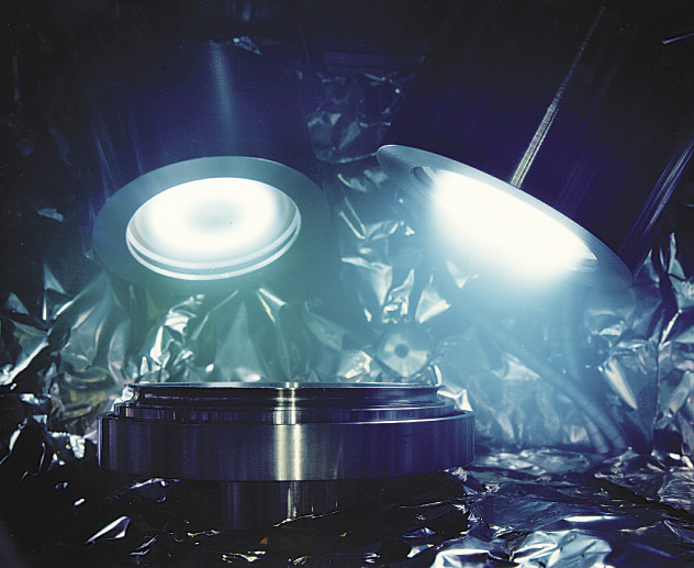

A sputtering cathode lights up under high voltage. Image courtesy Angstrom Sciences.

HIPIMS is a derivative of a process called magnetron sputtering, in which a high voltage is applied to a sputtering cathode that deposits a plasma coating on the target surface while accelerating argon ions toward the target. The argon ions project the sputtering material onto the surface, depositing the coating.

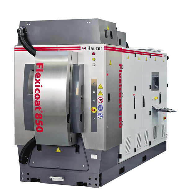

“One version uses relatively short, very-high-power pulses, and the other is lower power but gives the ability to program the pulse shape,” explained Michiel Eerden, tooling product manager at IHI Hauzer Techno Coating B.V., Venlo, Netherlands, which offers both variants, as well as arc evaporation. “The results are functionally very similar, but we decided to adopt both in order to offer our customers what is most useful for their application.”
Usually, the lower power-supply costs and shorter turnaround associated with arc evaporation win, he continued, but whenever the job involves a soft or sticky substrate that tends to adhere to the cutting tool, the additional cost of HIPIMS is worth considering.

Hauzer's Flexicoat coating equipment offers multiple coating technologies, including variations on arc evaporation and HIPIMS. Image courtesy Hauzer Techno Coating.
Hauzer’s Flexicoat coating equipment offers multiple coating technologies, including variations on arc evaporation and HIPIMS. Image courtesy Hauzer Techno Coating.
