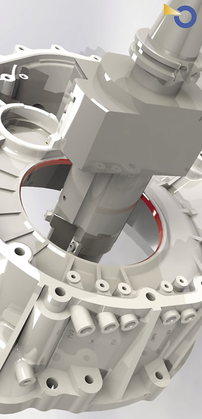

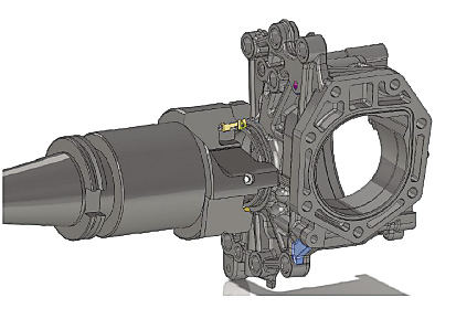

Rigibore designs and develops CAT 50 special boring tools and special turning tools, including ones for General Products. Images courtesy Rigibore.

Based on the gains realized with Smartbore and after an evaluation of other options, Amstutz enlisted Rigibore’s support to machine an A-383 aluminum, die-cast axle housing for a leading 4×4 automaker. For the job, Rigibore designed, with the assistance of its specialized RADS (Rigibore Automated Design System) software, and produced three special boring tools that rough and finish simultaneously.
“It’s got the roughing insert and the finishing insert in the same tool. They’re just offset from one another,” Amstutz said. “Instead of using two tools, I can do it with one.” This enabled General Products to reduce its tool requirements by 40 percent.
According to Rigibore, its previous successful projects outlined combination tools as an effective means of significantly reducing cycle time. By having multiple cutting edges on one boring bar, two critical diameters can be machined in “one shot.”
