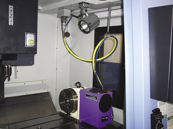

CNC Engineering’s custom rotary table comes with a single PVC cable with a waterproof connector that can be connected or disconnected in a few seconds with a half turn. This cable has proven to be highly durable and remains flexible after years of use. Image courtesy CNC Engineering.

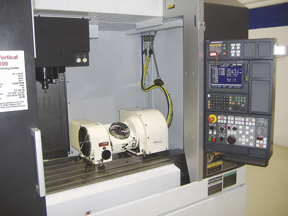

Many CNC Engineering customers want to use old rotary tables on new and old machines, according to the company. Image courtesy CNC Engineering.

These tables are being purchased for old and new machine tools, according to Conley. “Often our customers would like to be able to use an older rotary table on a new machine, as well as an older machine. Depending on the control vintages, we can often accommodate that need,” he added.

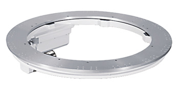

The Weiss rotary indexing ring has a large central opening to allow a customer to position all tooling and cables internally. Image courtesy Weiss North America.

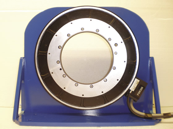

The Planar ServoRing from IntelLiDrives is designed to eliminate backlash, friction and wear problems associated with worm, gear and belt drives. Image courtesy IntelLiDrives.

Weiss North America introduced the first rotary indexing ring, which features a large central opening. “This allows the customer to internally position all tooling, cables, etc. and to work from the inside out, saving sought-after floor space,” Treter said. “From there, we moved to servomechanical, offering another option utilizing the same design yet incorporating the flexibility of servotechnology.”

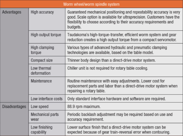

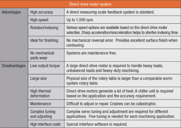

Rotary tables: worm vs. direct drive
Koma Precision, which distributes Tsudakama rotary tables, offers a detailed comparison chart (www.komaprecision.com) for those interested in some of the advantages and disadvantages of a worm wheel vs. a direct-drive system. Here are some of the differences that distinguish the rotary tables from one another.
Options to consider when selecting custom work-positioning device
Table courtesy Koma Precision
