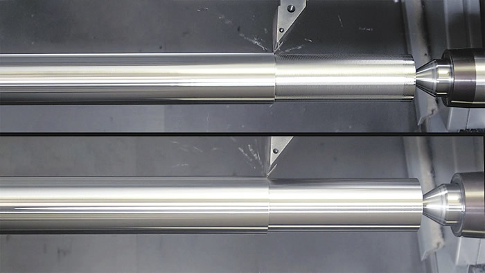

4. Chatter
Unlike most of the other challenges discussed here, chatter is almost completely avoidable.
“Chatter is usually caused by [using] incorrect speeds and feeds or because of lack of rigidity in the part or in the tooling, resulting in increased harmonics and vibration,” explained Hurco’s Cope. “Once chatter starts to occur, it is almost impossible to stop. Therefore, we want to stop it before it starts.” Increased feed rates and a larger tool-nose radius can help, he continued, as large tool-nose radii can accommodate higher feed rates and still impart the desired smooth surface finish.
Chatter can lead to an uneven surface finish (top); a proper setup can eliminate chatter, resulting in a fine surface finish (bottom). Image courtesy Haas Automation.
Graham said anything that causes deflection will cause chatter. Cutting with a dull edge, either through improper initial selection or one that has been worn down, a lack of proper support for the tool or toolholder, cutting a springy material such as titanium without the proper geometry, built-up edge resulting from poor chip control and heat management—all of these can cause chatter. So what’s the
solution?
“It’s easy to say ‘fix the setup,’ but in practice, it’s more difficult to do,” Graham said. “We tell people to try and get as rigid of support as possible, to get the lowest overhang on the part that’s being machined, the lowest overhang on the toolholder and use a steady rest if possible. If you’re doing a shaft, you can use two toolholders at opposing ends for additional stability, if your machine has a second turret. You can use a tool above and below the shaft so the opposing radial forces balance each other. Sharper cutting edges also minimize tool pressure.

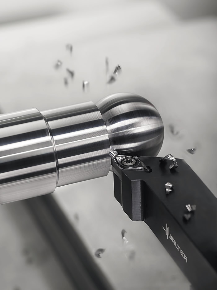

5. Chip Control, Evacuation
Cutting will result in chips, and where there are chips, there is a need to evacuate them from the cut. Chip control is an especially challenging issue when turning, explained Walter’s Ludeking, because the tool is continuously in the cut. The result is that a turned chip has no natural breaking-off point as do other operations, such as milling. As a result, the chip must be curled upward and broken by a chipbreaker, but this introduces additional heat to the operation.
Walter’s MP4 geometry is for chip control in a variety of feed and DOC conditions, according to the company. Image courtesy Walter USA.
“The more aggressive the chipbreaker, especially in harder materials, the more heat you generate,” he said, “which brings us back around to the need for proper coolant application. There are lots of different turning insert geometries for chip control, but it’s always going to be a trade-off because of that extra heat.”
Chipbreaker geometries work in conjunction with the applied feed rate to control chip formation. Tighter chipbreaker geometries enable lighter feed rates, but if the feed rate is too low, the chips might be long and stringy (not self-breaking), or if the feed rate is too high, they might weld to the cutting edge.
Chip evacuation—removing chips from the cutting zone—also ties into surface finish, noted Hurco’s Cope. If the chips are making contact with the workpiece during the machining process, or if chips are being recut, odds are the surface finish will be negatively impacted.
“Controlling chips in a turning operation differs from other operations, because the chips often get wrapped around the spinning workpiece itself,” he said. “In milling operations, for example, you can simply keep coolant or air aimed toward the tip of the tool and prevent any chips that might be lying on the surface of the workpiece from making contact with the cutter by directing them out of the way.
“With turning, using the correct insert to break the chip, to prevent the long stringy chips from forming, becomes very important.”
