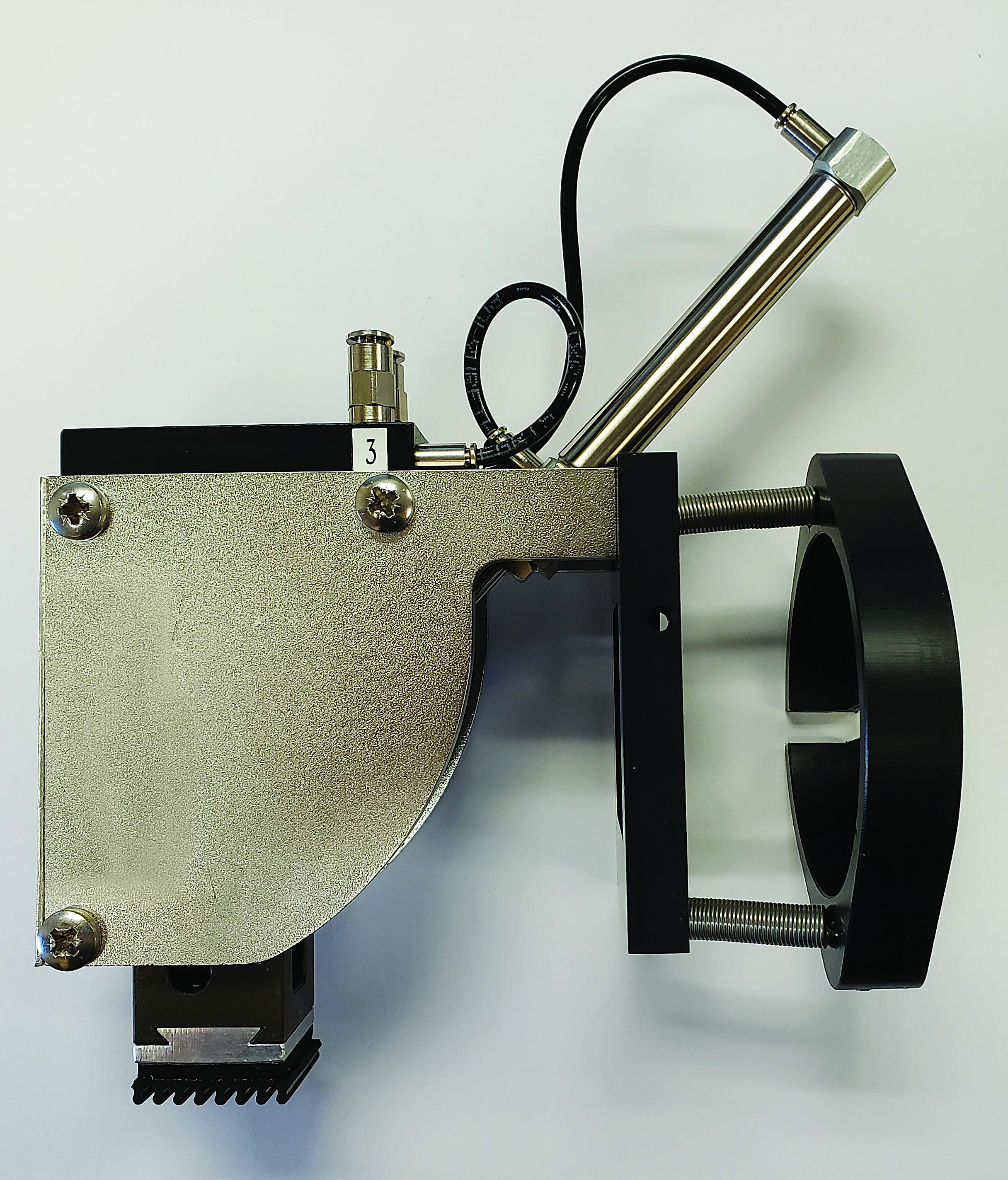

Sprinter Marking has a roster of standard marking machines and can customize depending on the application. Shown are the Model 28 (left), which has a maximum marking area of 3⁄8″×1″, and Model 22, which can imprint a dot symbol that measures up to ¼”. Image courtesy of Sprinter Marking
A reciprocating coder marking head moves from the ink supply reservoir and extends to an ink marking position where it contacts the part. The head then returns and waits for a signal to initiate action, said John Bishop, principal at Sprinter Marking Inc., Zanesville, Ohio. These pneumatic-powered devices use a wet-ink cartridge and rubber type to print an image on a substrate. The coders use interchangeable rubber dies to quickly change the printed message. Dies can be ordered in custom strips, in standard strips, as single characters and in kits so customers can mix and match character sizes, symbols, logos and other characters.

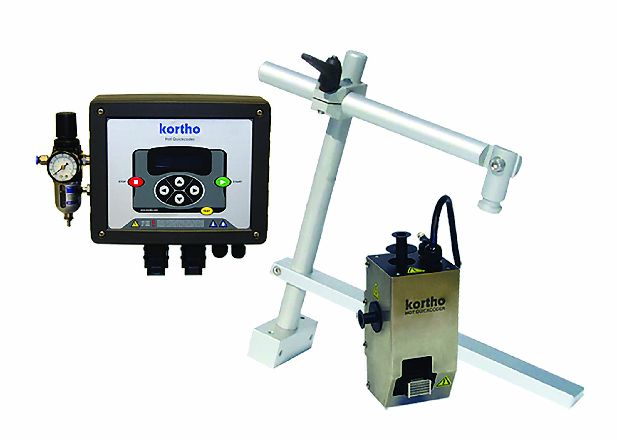

The Kortho Hot Quick Coder, left, can mark products in motion at speeds up to 60 m/min. and at cycle rates up to 300 prints per minute. Image courtesy of Universal Stenciling & Marking Systems

Another product is the Kortho Hot Quick Coder from Universal Stenciling & Marking Systems Inc., St. Petersburg, Florida. The device uses dry-ink rolls that are heated prior to use in a self-contained heating system to make them fluid, said Don Wright, president of Universal Stenciling. “Once the ink is transferred to the part surface, it dries immediately. You can pick it up immediately after the transfer, and the ink is dry.”
The unit operates at line speeds up to 196 sfm. The Hot Quick Coder is pneumatically operated, Wright noted, but the type face itself is mounted using four shoulder screws with compression springs under them and rests about 1mm to 2mm off the surface. “When it comes out under high speed, the type contacts the product, and it bounces off so quickly that it doesn’t allow the imprint to smear.”
