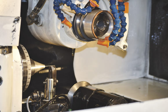

The Unison Model 2850 tool grinder has a “pop-up” steady rest to support small-diameter drills.
The foremost challenge when manufacturing microdrills, Marion explained, is overcoming their virtual lack of stiffness, which makes them difficult to support, as well as grip. Part of the manufacturing solution included a “pop-up” steady rest, which supports even the smallest diameter drill, according to Unison.
