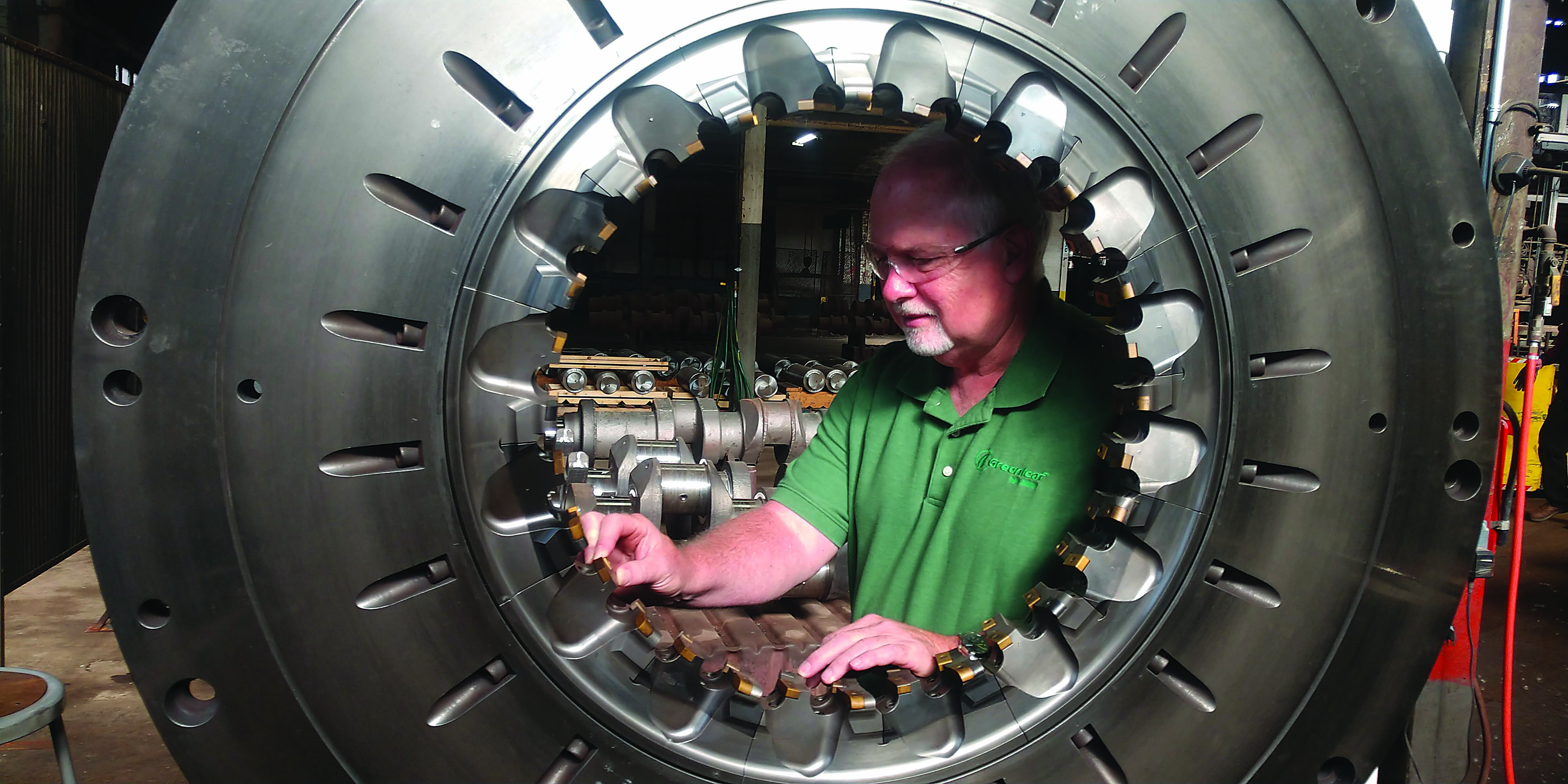

Denny Carpenter, sales and service engineer at Greenleaf, inspects milling cutter inserts and segments. Image courtesy of Greenleaf
“We wanted to be able to use some existing cutter bodies and apply new technology to them,” said Denny Carpenter, sales and service engineer at Greenleaf.
The cutter bodies were altered to encapsulate a segmented design, which allowed more insert pockets, increasing the number of inserts by 25%. The design enables OCCO to change worn segments.
