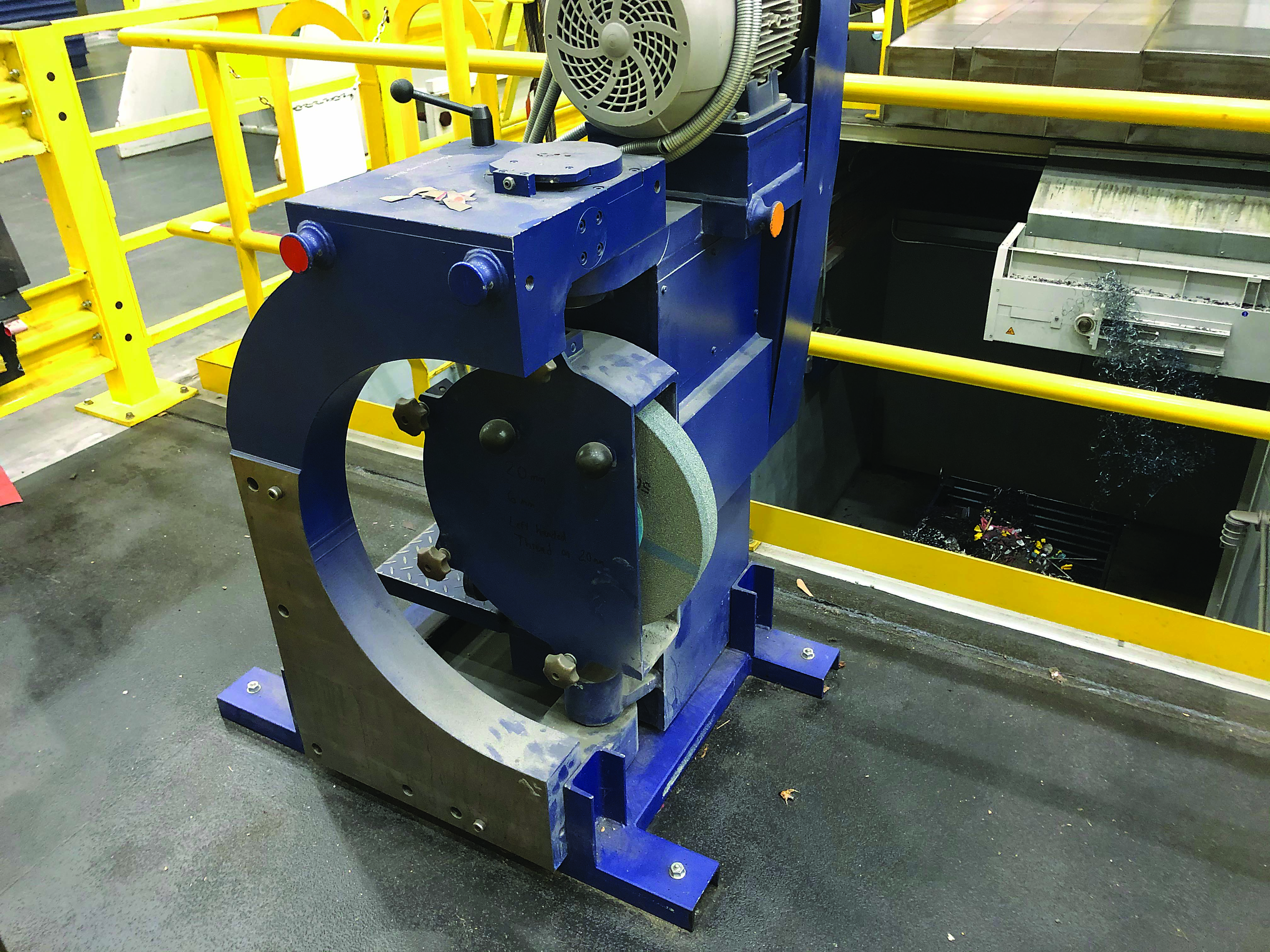

The grinding attachment for the 200 metric ton (220 ton) lathe at Mitsubishi Hitachi Power Systems Americas uses a large aluminum oxide wheel. Image courtesy of C. Tate

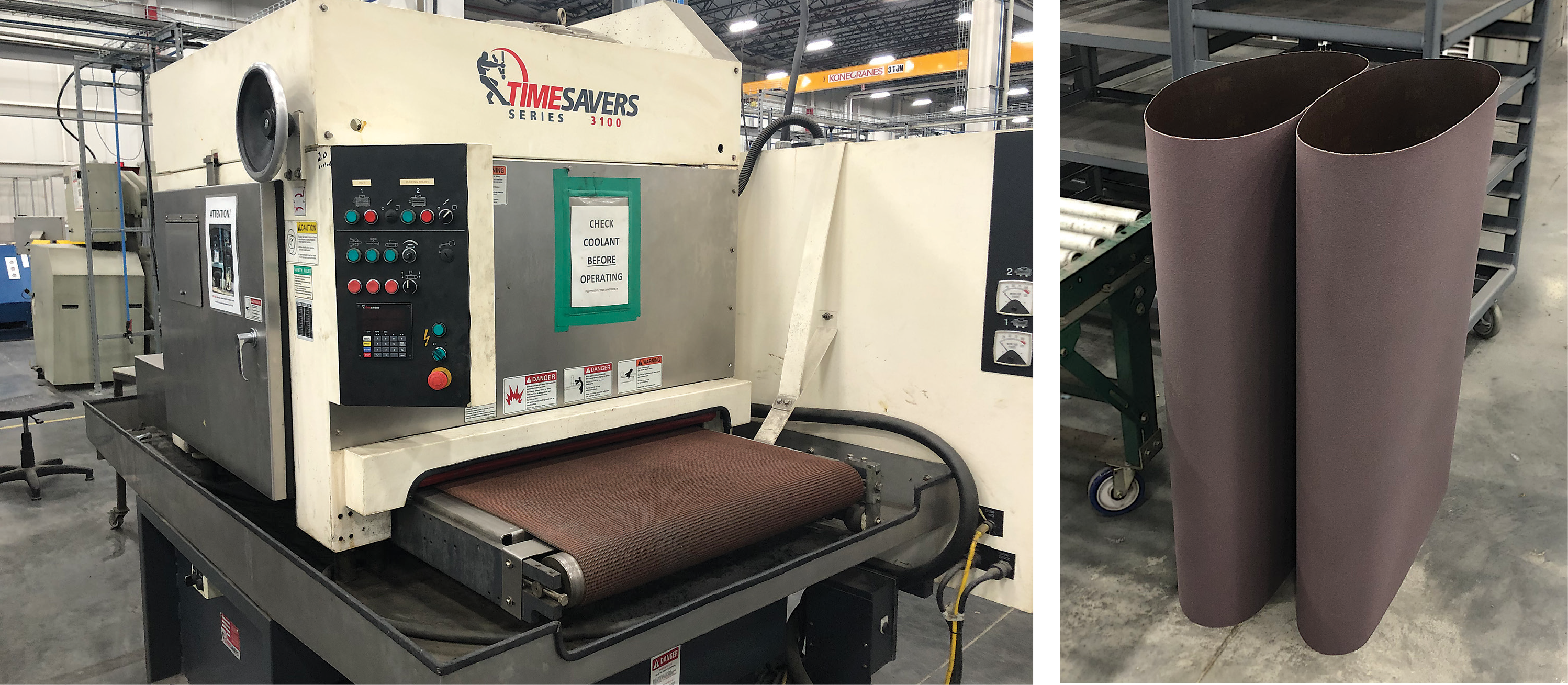

The sanding machine (left) at Mitsubishi Hitachi Power Systems Americas uses 914 mm × 1,829 mm (36″×72″) sanding belts (right) to polish parts made of sheet metal. Image courtesy of C. Tate
