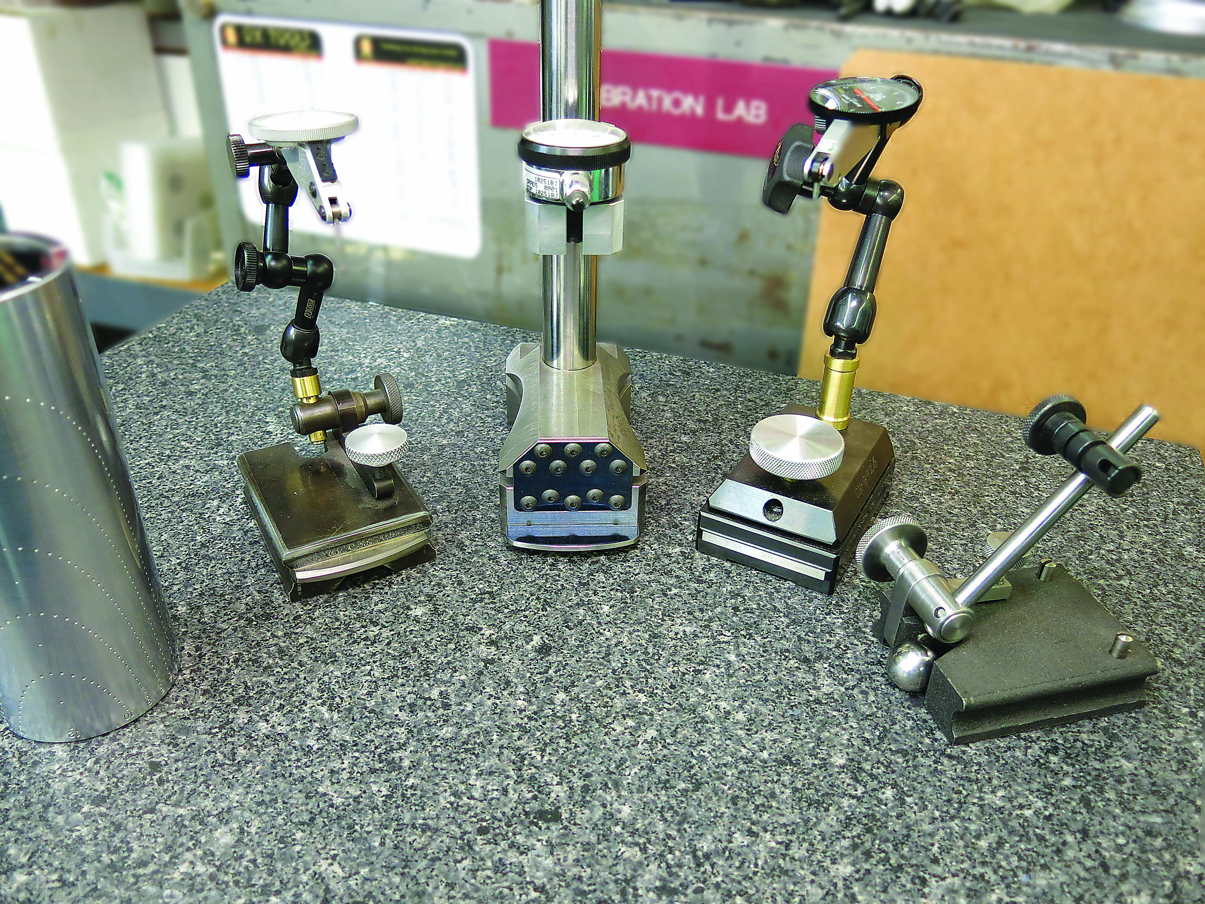

Figure 1. Tool and die makers have at their disposal simple, elegant tools for squaring parts to tight tolerances. Images courtesy of T. Lipton.

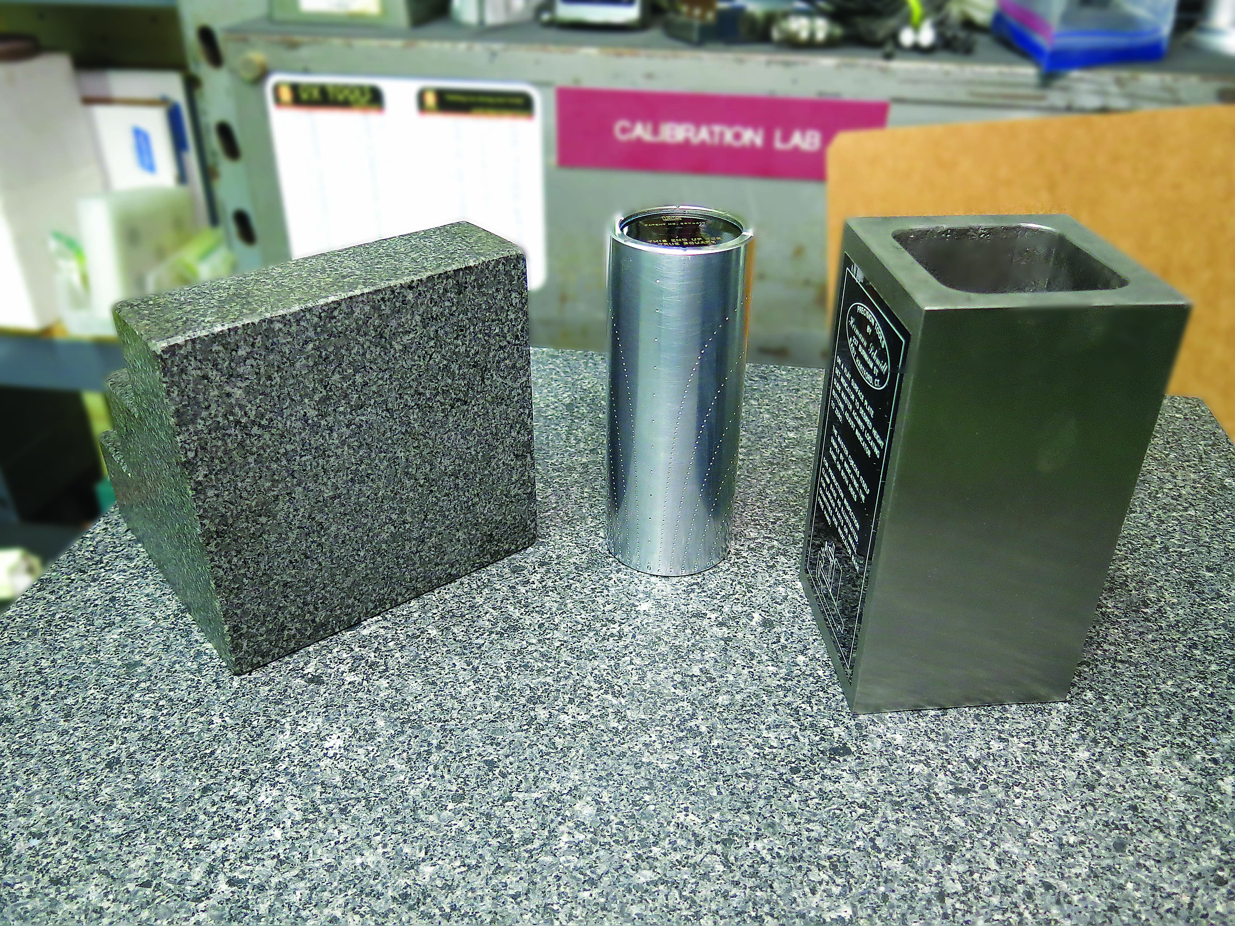

Figure 2. Normally, commercial and modified surface gages, which are sometimes called squareness comparators, are set using a master square reference, such as a cylindrical square, or a known calibrated right angle.

The good news is that clever tool and die makers have been doing it for years. Figure 1 shows some of their simple, elegant tools.
Normally, these commercial and modified surface gages, which are sometimes called squareness comparators, are set using a master square reference, such as a cylindrical square, or a known cali-brated right angle (Figure 2). A neat thing about this self-proving method is that users can establish their own perfect square reference, without access to any master right angle. By exploiting basic high school geometry, you can find dead-true square, as long as you have a basic, known, flat surface plate as a reference.

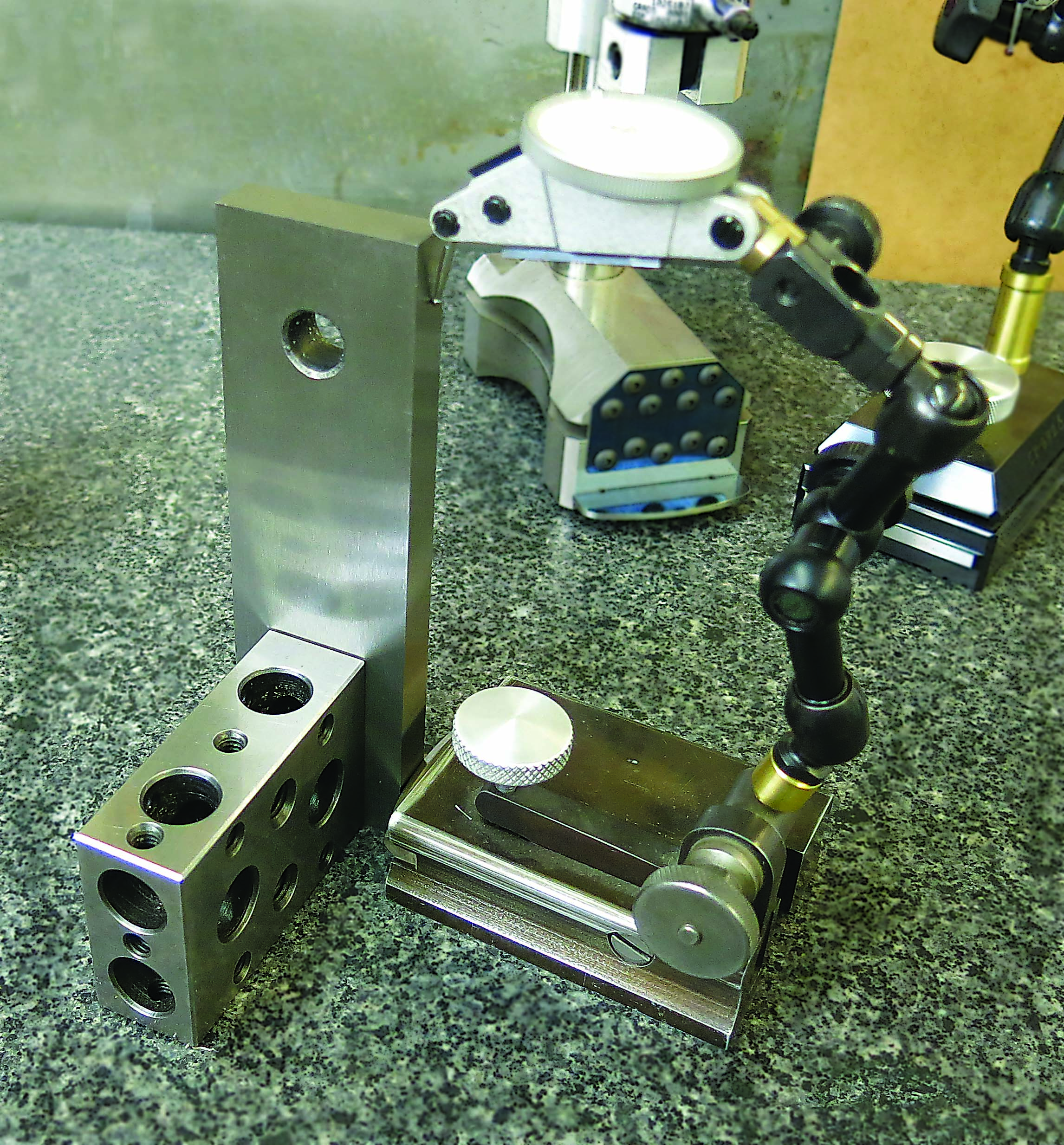

Figure 3. A common shop steel attached parallel to a 1-2-3 block as a demonstration piece for determining a true perpendicular reference.
The secret of these surface gages lies in the foot, or ball, projecting from the front near the base. The foot is rocked in a small arc when in contact with the part or calibration reference, and the high reading of the indicator sweep is the actual perpendicularity measurement. The instrument is typically set to zero on the right-angle reference, and part perpendicularity is plus or minus some dimension from the true-square zero point. The flat-faced model simply is butted against the part, reference or both, and the indicator is then zeroed.
Figure 3 shows a common shop steel attached parallel to a 1-2-3 block as a demonstration piece for determining a true perpendicular reference. The parallel is easy to verify accurately by sweeping the top surface relative to the surface plate with an indicator. Once it is confirmed as truly parallel, you can construct your right-angle reference. It makes no difference if it is actually perpendicular when you start, but the closer it is to eyeball square the better.
Using basic geometry, you can start with either of the two sides that were confirmed parallel. With the comparator, you zero the indicator on the first parallel side. Moving to the other parallel side, you take a reading and find that the second side reads +0.004″ (+0.102mm). We know now that dead-true perpendicular is exactly half the difference of the two readings, or +0.002″ (+0.051mm). If you zero the comparator at half the difference, you are now dead square. As proof, recheck the setup—your actual readings should show +0.002″ and -0.002″, respectively.
