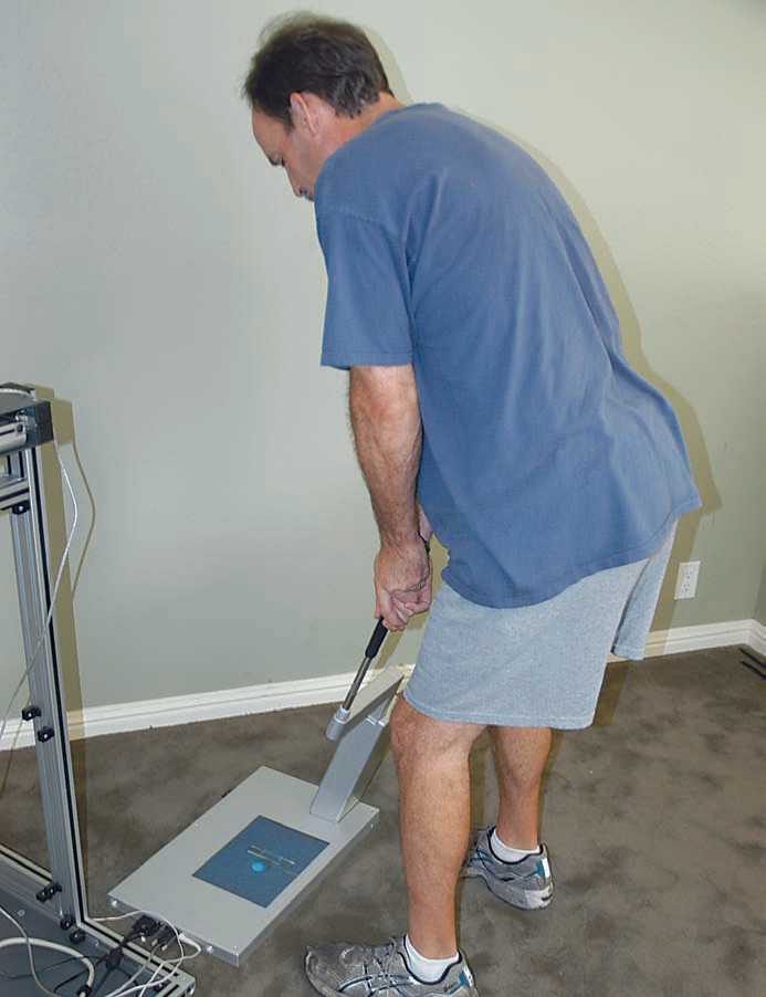

Kevin Burns, president of Kevin Burns Golf, uses a device (top) to document the angle he holds a putter at and the required shaft length for his stance. That information will be downloaded to a machining center, where a customized putter head is produced to fit an individual’s specifications.

To develop a unique putter, Burns developed a kiosk using a computer that will capture the customer’s customization information at retail stores. A patented device will capture the angle a golfer holds a putter at and the required shaft length. This information will automatically be sent to Burns after the purchase. It will be downloaded to the machining center and a custom putter will be produced within 2 weeks.
