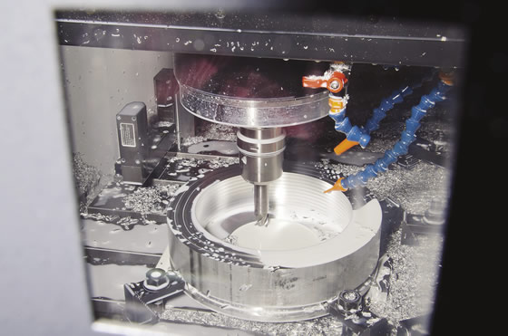

A prototype part is machined on Fallbrook’s Makino V56i Pro 5 vertical machining center. Image courtesy Makino.

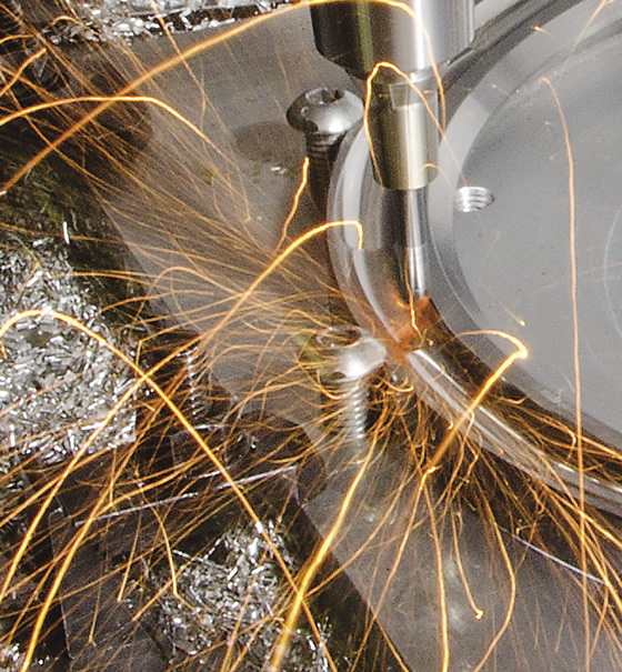

Fallbrook is able to impart surface finishes as fine as 0.1µm Ra on its Makino V56i. Image courtesy Makino.

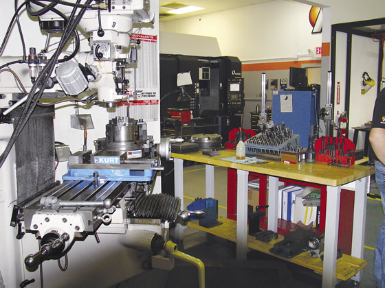

The prototype shop includes a mix of general-purpose and high-performance machines. Image courtesy A. Richter.

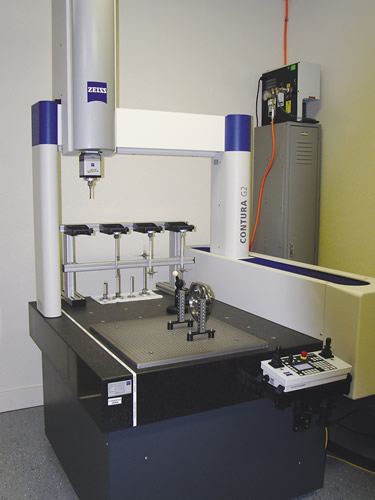

A part is positioned for measurement on a Zeiss Contura G2 coordinate measuring machine in Fallbrook’s metrology lab. Image courtesy A. Richter.

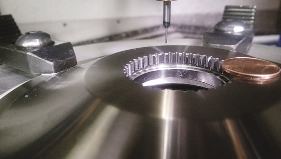

An involute spline is roughed with a 0.031″-dia. endmill. Image courtesy Fallbrook Technologies.

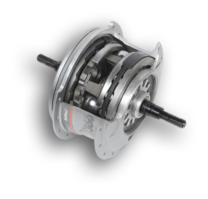

A cutaway of Fallbrook’s NuVinci continuously variable planetary transmission hub. Image courtesy Fallbrook Technologies.
