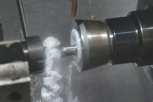

Ribbon-like chips characterize machining of a 1.8 “-dia. UHMWPE hip implant liner at Orchid MACDEE. The process imparted a surface finish of 15 µin. Ra right off the machine. To view a video of parts being inspected at MACDEE, click here.

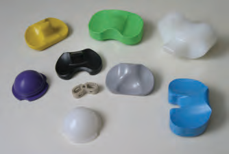

A selection of permanent and trial orthopedic implants machined at Orchid MACDEE. Permanent implants generally are white, but trial implants are machined in different colors, often to designate the different implant sizes.

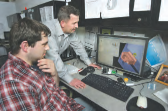

Programmer Nic Haroney (left) and Sales Manager Mike Ulanowicz discuss the CAM program for a spinal cage component to be machined from PEEK polymer at Orchid MACDEE.
