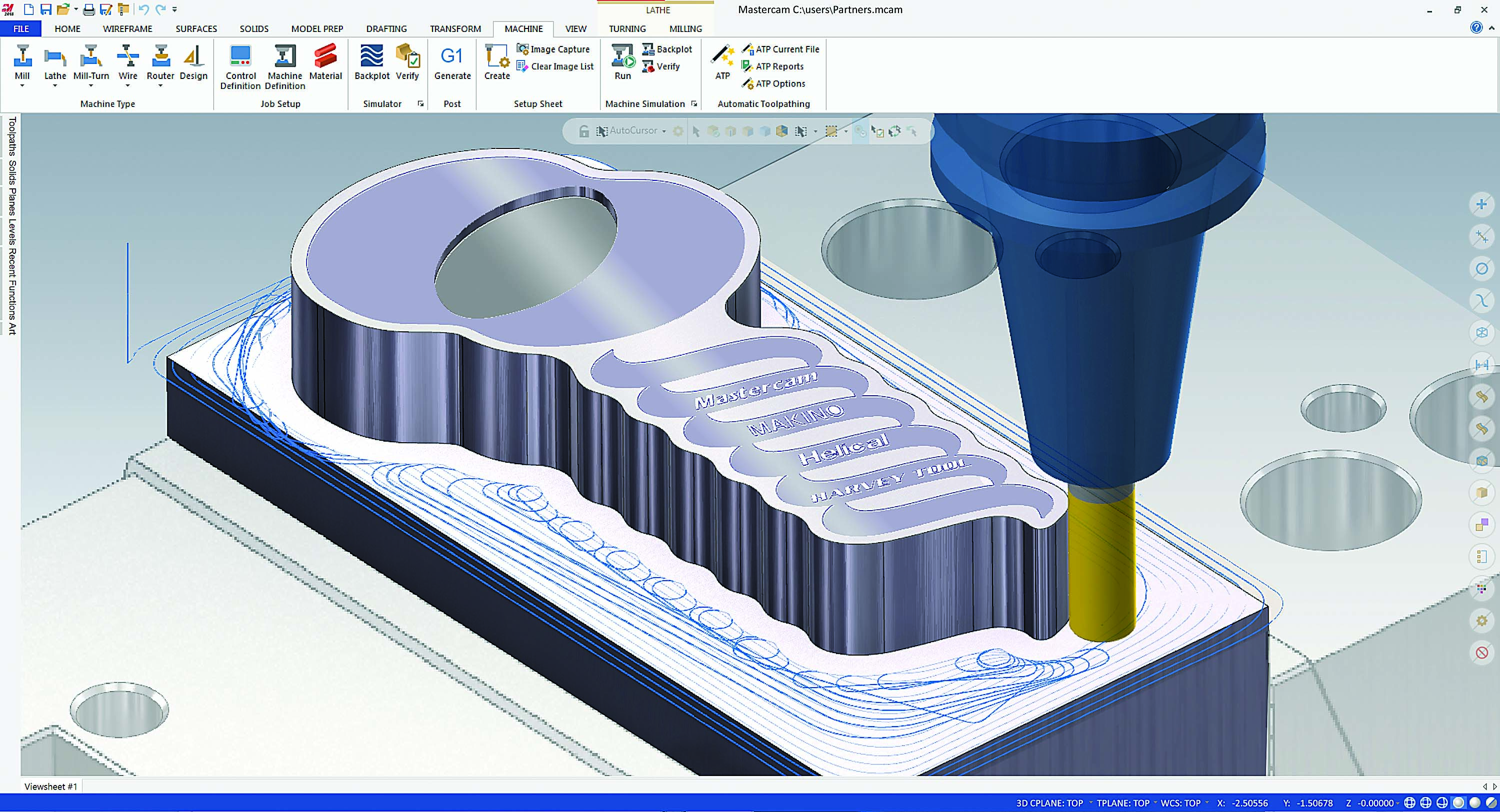

Mastercam’s Dynamic Motion roughing toolpaths contributed to ambitious material removal in the demo part. Image courtesy of CNC Software
An example of a recent project was among CNC Software Inc. (the CAD/CAM software), Helical Solutions LLC (the cutting tool) and Makino Inc. (the machine tool). It all began when Helical Solutions sent an email introducing its high-efficiency six-flute endmill with a chipbreaker. Mike Fecteau, senior applications engineer at Makino’s mold and die facility in Auburn Hills, Michigan, received that message, was intrigued and wanted to test the endmill on a high-horsepower, general-purpose machine platform. He reached out to Don Grandt, national application engineer at Harvey Performance Co. LLC, which owns Helical Solutions. Grandt then contacted me, knowing that our Dynamic Motion toolpath would help get the most efficient speed results out of the tool.
Grandt’s goal from the start was to achieve a material removal rate of 655 cm³/min. (40 in.³/min.). That’s an aggressive aim with a 12.7 mm (0.5″) endmill. In addition to programming, my role was to design a 4140 alloy steel workpiece that looked cool but also had to have “real” part features that would be common in a mold or die component. We didn’t want this demonstration to be in a tightly controlled environment with conditions that couldn’t be replicated on a shop floor. We wanted to show that when these three elements are combined — a dynamic toolpath, a high-efficiency cutter and a well-built machine — these are the results that users can expect.
After several emails back and forth as Fecteau ran tests in Michigan and tweaked horsepower, speeds and feeds, he actually could increase all those aspects. So we then had our demo and the research to share with peers and end users. The operations involved roughing, finishing, chamfering and engraving. Here were the results:
Roughing
  • Tool: Helical Solutions 12.7 mm, 0.76 mm (0.03″) radius, six-flute chipbreaker
  • 10,695 rpm and 30.8 hp used
  • 13,513 mm/min. (532 ipm)
  • Axial depth of cut: 25.4 mm (1″)
  • Radial DOC: 1.905 mm (0.075″)
  • MRR = 655 cm³/min.
