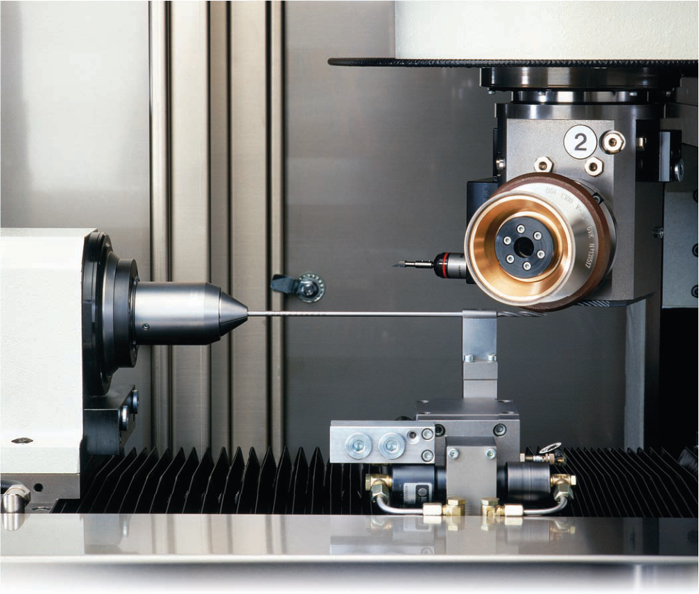

A surgical drill being ground on an EWAG Rotoline machine.

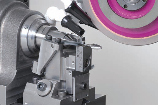

Courtesy of Rollomatic
Rollomatic Nano5 grinding of a tree-shaped rotary carbide bur with brazed shank using five CNC axes.
“We also use Regal Diamond Products’ copper-bond grinding wheels for all of our medical applications,” Mc- Kahan said. “The copper bond is bound with a copper base that goes to the core of the wheel and displaces the heat up to the core. That wheel is one of the biggest advances I’ve found to combat burning and burring. And I have yet to run into an instance when it has failed.”
As for deburring, McKahan reserves a wheel slot on the CNC to do the operation online with a brush wheel. “I’m able to program it to mimic the grinding in a deburring fashion,” he said. “People have a tendency to think you have to bury the wheel to debur, but it’s just the opposite,” he added. “If you grind the parts right, the burrs should be very light and flaky, and flick off easily. If you bury the wheel in there, it can push the burr back down into the flute or hole.”

“The difficult parts are the very small, long drills; they’ll flex and move,” said Simon Manns, tool grinding applications manager for United Grinding Technologies. “Because it’s gummy, the part will try to pull itself up into the wheel.” He recommended using a steady-rest workholder with a bushing that provides more than 180° of encapsulation.

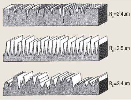

The three surfaces have approximately the same Ra, but the peaks and valleys are very different.
Tips for measuring surface quality
To get a detailed assessment of a part’s surface quality, you need a measurement method more exacting than Ra (arithmetic average roughness), said Ed Reitz, global market manager for Saint-Gobain Corp, Worcester, Mass.
While Ra can provide a general indication of a finish, Reitz continued, it’s based on an average value of a surface’s peaks and valleys. And a variety of different surfaces can generate identical numerical values.
“You could have one surface with a fairly high bearing area and a few very deep scratches, but an otherwise shiny appearance, and another surface with a very uniform finish with a matte appearance—and they each could generate the same Ra,” Reitz said.
Reitz’ preferred measurement method is finding a part’s Rmax (maximum roughness) readings. Rmax, he explained, measures the maximum peak-to-valley distances within a sample length. “It gives you an indication of the worst you can expect out of that particular surface,” Reitz said. “What’s important about that type of measurement is that it helps isolate any random scratches or anomalies, whereas Ra tends to blend those out.”
As a rule of thumb, if a part’s Rmax value is below a factor of 10 of the Ra measurement, it generally indicates a good and consistent surface finish, according to Reitz. “Let’s say the customer’s surface requirement is for a relatively smooth 15μin. Ra value,” he continued. “If the Rmax value is less than 150μin., then we can say that the finish is relatively consistent. But if you get an Rmax of 300 or 400, the finish is not consistent and you’ll be able to see or feel and measure some of the deep random scratches that typically are not acceptable.”
