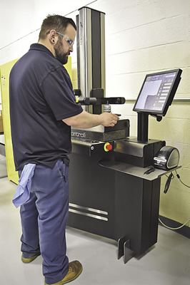

Joshua Palotti, lead CNC specialist at OKAY Industries, checks a tool on the Hathor Six offline tool presetter from Koma Precision. Image courtesy Koma Precision.

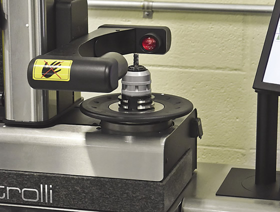

Koma Precision offers the Elbo Controlli Hathor Six for setting tools offline. Image courtesy Koma Precision.
OKAY took test cuts to ensure the cutter geometry was correct, but that was a time-consuming and cumbersome process for setting and adjusting tools. “Any time you changed a tool, it would take about 15 minutes if everything went smoothly, and up to an hour if things went poorly,” Palotti said. “We needed an offline presetter to easily check a wide range of tool types.”
In addition to researching four different models, Palotti said the acquisition process involved physically examining two presetters. The first was at another part manufacturer’s facility, where OKAY’s group of operators, setup personnel, management and manufacturing engineers watched tools being set up before the data was sent to the machine tools. The company also visited Koma Precision Inc., Windsor, Conn., where OKAY personnel used an Elbo Controlli Hathor Six offline tool presetter to set tools.
In addition to having an existing business relationship with Koma, Palotti said OKAY personnel appreciated that the presetter’s software platform is easy to use, enabling the company to tailor the unit to an application and a user’s ability.
“On a specific job, you can set up a library of tools and then when you select a tool, the presetter will automatically select the measurement technique,” he added. “It takes out a lot of the opportunity for error.”
Initially, OKAY dedicated the Hathor Six presetter to a small work cell of two to three machines and quickly saw a tremendous reduction in setup times by eliminating test cuts. “Now that we’re doing it off-line, it brought the billable time to zero because we are setting all the tools while a machine is running,” Palotti said.
After 6 months, OKAY decided to train all of its operators and use the presetter on all 23 milling machines in its main facility. Training a new operator takes about an hour, whereas new setup workers require a half a day because setting tools for new jobs is more involved. “It takes about a week before people are really comfortable using it,” Palotti said.
