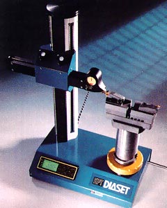

Operator Robert Finegan prepares to preset a roughing head with the KPT Diaset contact presetter on the workbench at Quality Machining Co., Columbus, OH.

Figure 1: The KPT/Diaset™ contact presetter has a large digital readout and a data memory with capacity for 15 separate zero points.
Contact presetters range in cost from about $5000 to $10,000. They use a probe that touches the tool to make measurements. Contact presetters may achieve overall accuracy of less than 0.0005″ and check runout to less than 0.0003″ TIR (Figure 1).

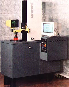

Because they are more sophisticated, noncontact (optical) units generally cost more than contact presetters. However, noncontact presetters are now more cost-efficient than ever before. In the past, a basic projector-type tool presetter cost more than $30,000; today, a benchtop projector-based system can be purchased for less than $15,000.
By using shadow graphs, noncontact presetters provide a view of the tool profile for both inspection and presetting. Users of these systems can measure tool length and diameter, calculate nose radii and angles, and detect damaged or unusable cutting edges. Noncontact presetters minimize the possibility of chipping the tool’s cutting edge when setting the tool-offset distance. They also allow the user to monitor and statistically document tool runout in the holder—even in hollow mills, trepanning tools, and short tools that cannot be monitored by using contact presetters.

Figure 2: The KPT/Speroni Model STP-56 high-precision noncontact presetter can position accurately within 0.000040″.
The technological innovation of vision-based tool measurement, combined with faster computers, has taken the art of highly precise tool-inspection to new levels. They can position accurately within 0.000040″, even when measuring tool diameter. Only the most accurate systems will have a resolution this fine. Because presetters measure radially from the centerline of the spindle out and double the value for diameter, a 0.000020″ resolution on the radius is required to provide a 0.000040″ on the diameter. These highly precise noncontact systems also will have a maximum TIR at the full travel length of the presetter of 0.000078″ or less (Figure 2).
