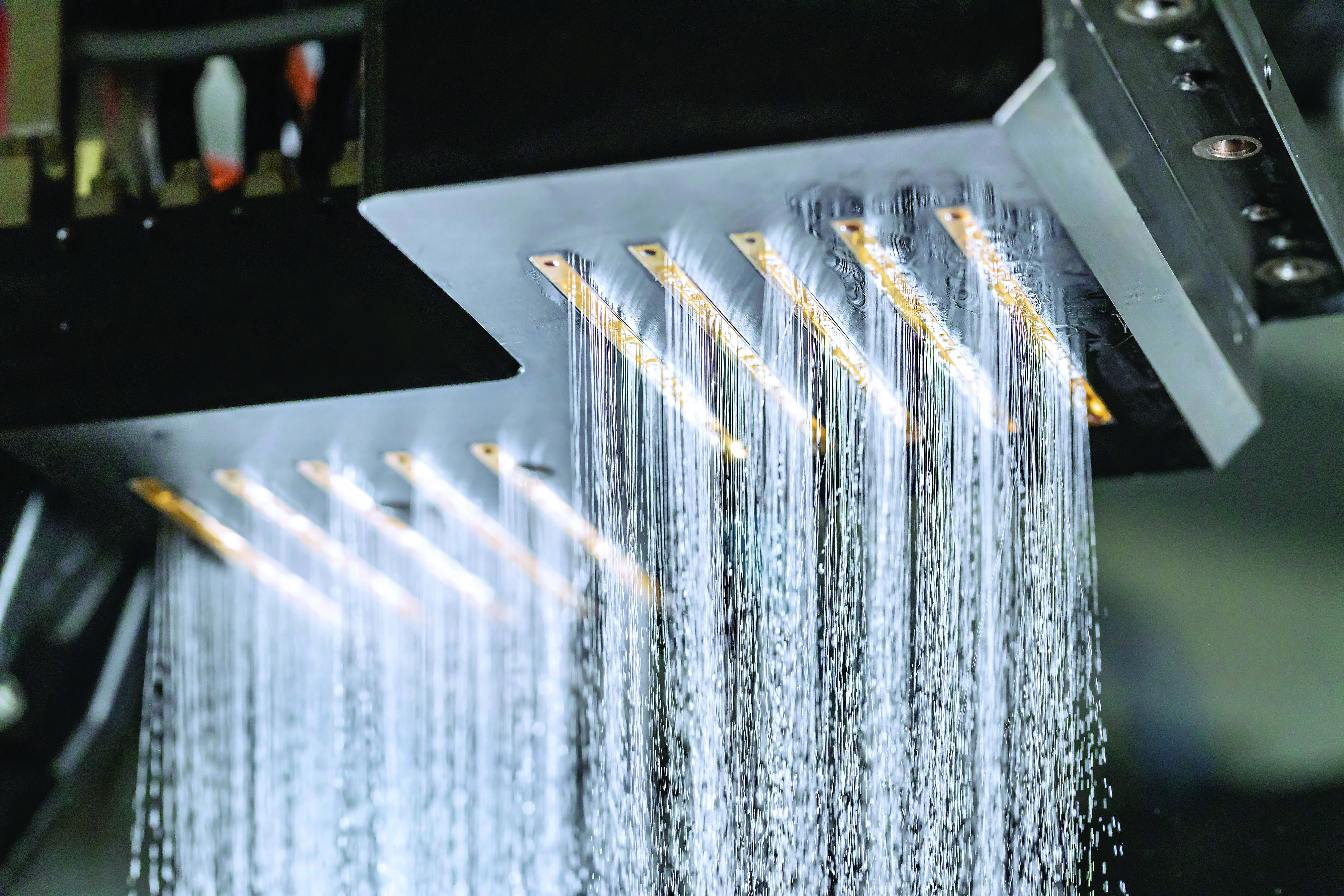

Print heads precisely apply binder to metal powder to build parts layer by layer. Image courtesy of ExOne
“I think it’s more challenging for this type of technology because it is so many different aspects of manufacturing smashed into one box,” Murphree said. “Normally, these are all broken out into separate steps that can all have their own QA/QC associated with them.”
With processes like the laser powder-bed fusion, or LPBF, used by Velo3D, however, “you stick powder in one side of the machine and get parts out of the other end of the machine,” he said. “So (you have to) make sure that all the things that are happening within the machine are happening consistently and repeatably and at the level of quality that is required by the end use.”

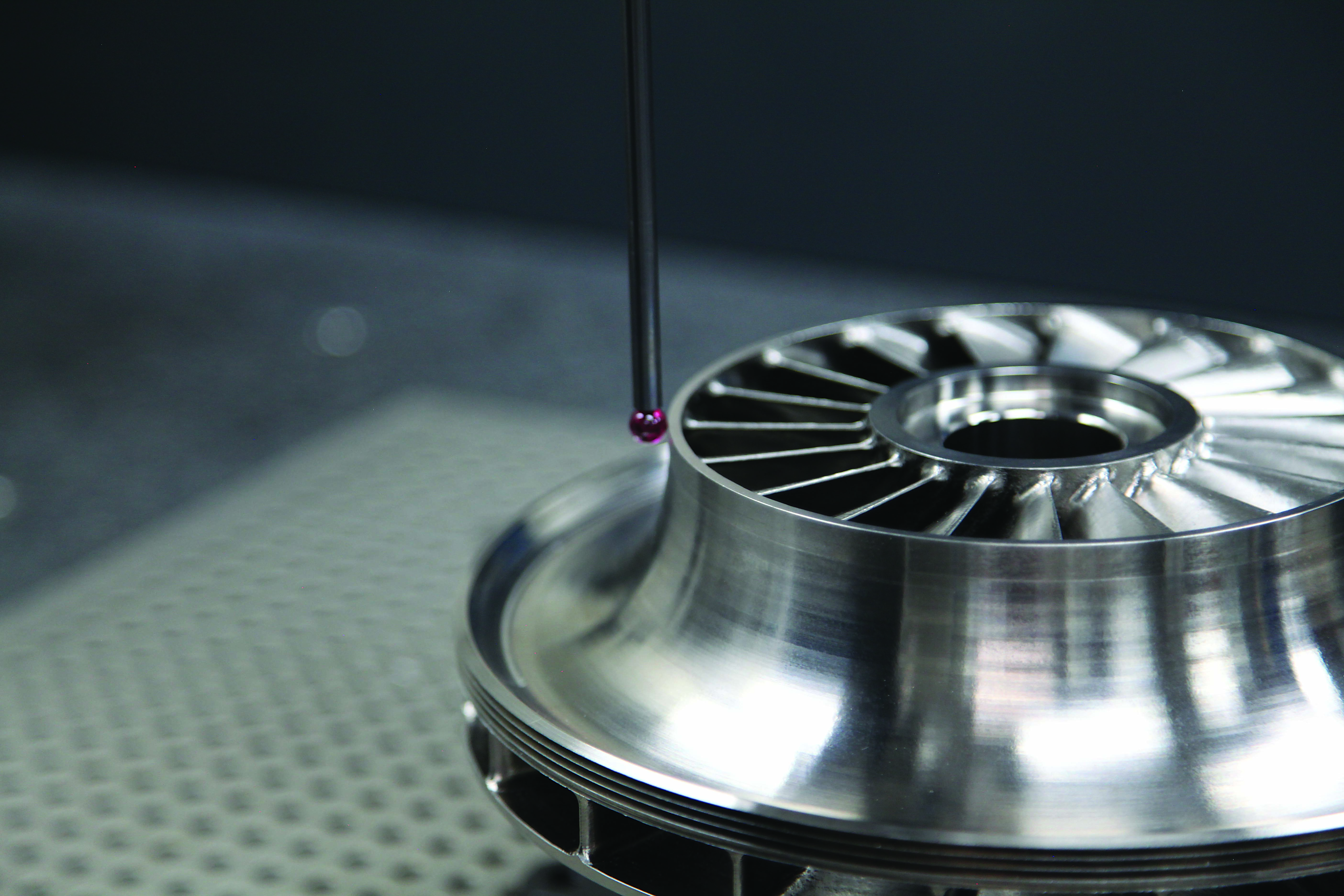

Compared with machining, additive manufacturing of metal components poses different challenges for quality control. In some cases, these stem from the fact that metal AM employs powders, potentially resulting in porosity in the end product, said Rick Lucas, chief technology officer at North Huntingdon, Pennsylvania-based The ExOne Co., which offers industrial metal 3D printing systems and services. In addition, he said there isn’t as much historical information about the powders used in metal AM as there is about machined metals.

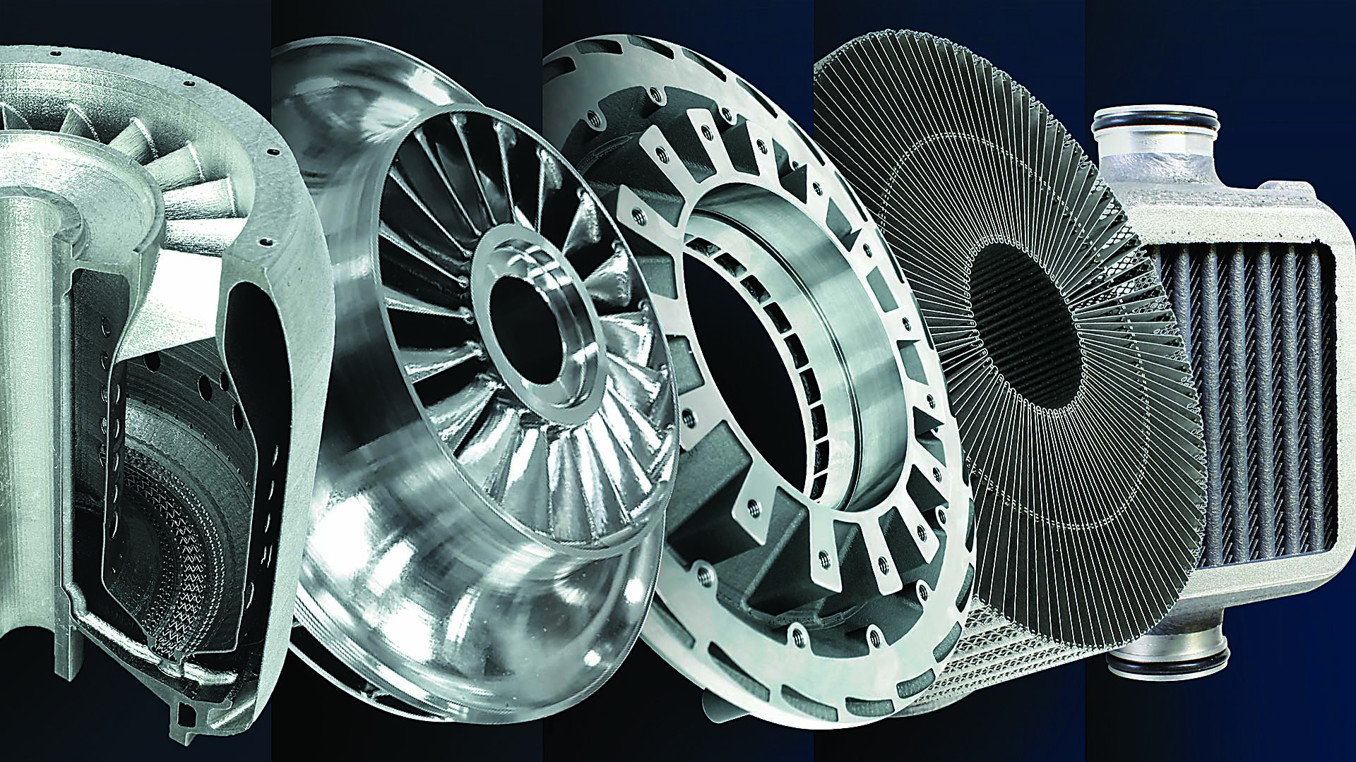

These metal industrial components were 3D-printed with a Velo3D laser powder-bed fusion system. From left to right is a cross section of a small engine, a supercritical CO2 impeller, a microturbine component and two types of heat exchangers. Each part was manufactured additively as a single piece. Image courtesy of Velo3D
Another popular AM metal is Inconel 718, which Murphree said is “relatively well behaved” in 3D printing processes. Inconel 718 is also well understood at this point because it is used widely in AM applications, he said.

An impeller undergoes coordinate measuring machine inspection to ensure dimensional accuracy. Image courtesy of Stratasys Direct Manufacturing
