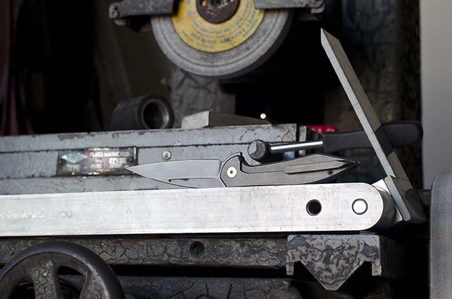

In addition, Spaulding wanted a tool that could effectively smooth feed lines on the knife blades that Zodiac manufactures.

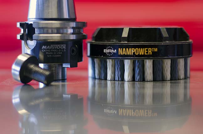

Spaulding viewed some videos online that showed NamPower abrasive nylon disc brushes from Brush Research Manufacturing Co. Inc., Los Angeles. Spaulding then purchased a 60mm-dia. (2.36″) Dot-style brush.
Productive Times: Brushing away chamfering
The NamPower disc brushes are composed of flexible nylon filaments bonded to a fiber-reinforced thermoplastic base. Image courtesy of Brush Research Manufacturing ​.
The brush proved to be effective, and Spaulding added to his tool library 60mm- and 100mm-dia. (3.94″) Dot-style brushes with a variety of grit sizes, including 320, 180, 120 and 80. “With a little trial and error, I figured out which brush works the best for me for different applications,” he said.
“I run our abrasive nylon brushes over any fairly flat part I have going in the mill,” he added. “I don’t want to use a chamfer tool for edge breaking or deburring if it’s not necessary.”
The disc brushes, which are composed of flexible nylon filaments bonded to a fiber-reinforced thermoplastic base, incorporate a combination of ceramic and silicon-carbide abrasives.
The abrasive filaments work like flexible files, conforming to part contours, wiping and filing across part edges and surfaces. They are suitable for a host of workpiece materials, including nonferrous metals, cast iron, mild steel, ductile iron, stainless and alloy steels, titanium and nickel-base superalloys.

Zodiac Engineering applies NamPower brushes to smooth feed lines on the pocketknife blades that it produces. Image courtesy of Zodiac Engineering.
“Chamfering tools are just half of the puzzle,” he said. “The other half is some sort of abrasive method, such as tumbling. However, tumbling can be impractical for larger parts or anything that needs to remain dimensionally unaffected.”
