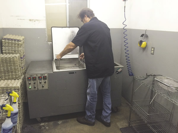

Lou Tignac, owner and president of Van's Manufacturing, removes a basket of parts from the company's Omegasonics Super Pro X2 ultrasonic parts cleaning machine. All images courtesy Omegasonics.
Lou Tignac, owner and president of Van’s Manufacturing, removes a basket of parts from the company’s Omegasonics Super Pro X2 ultrasonic parts cleaning machine. All images courtesy Omegasonics.

Tignac selected an ultrasonic cleaning machine from Omegasonics, also in Simi Valley, and soon realized benefits from the equipment. “With labor being the most-expensive component in a shop, any time you can cut down your cycle time or processes that require labor, you save money. Our Omegasonics system did just that,” he said. “We can clean parts in one-third of the time it took us prior to using ultrasonic technology.”
Tignac estimates that the ultrasonic machine halved the labor requirement for cleaning.

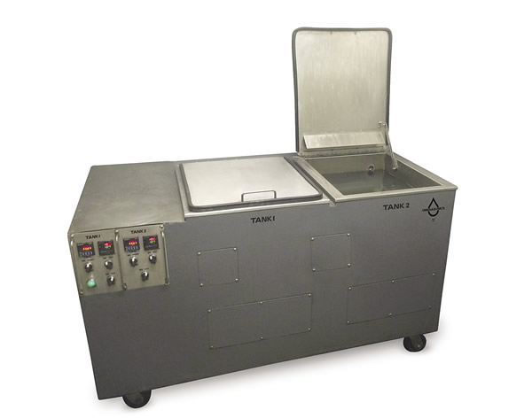

When it came time to replace the ultrasonic cleaning machine, Tignac selected the Omegasonics Super Pro X2 ultrasonic machine, based on his initial experience with the company’s equipment. This included ease of maintenance and use, competitive price point and reliability. The second machine, however, comes with a filtration pump, which keeps the bath clean and consistent for a longer period of time compared to the previous parts cleaner. A primary filter removes particles down to 20µm, and a secondary charcoal filter clears debris to a 3µm level on Van’s machine.
Removing the particles trapped in the cleaning fluid with the filtration system can double bath life, Tignac said, depending on the types of parts and the amount of debris on them prior to cleaning. For example, aluminum castings and carbon steel parts tend to “shed more” and create dirtier baths.

The Omegasonics Super Pro X2 ultrasonic parts cleaning machine features two cleaning tanks and comes with a filtration tank to keep the bath clean and consistent for a long period of time.

“With the old machine, there were a couple times where we ruined the bath because we had particles in there that we could not take out,” he said. The company then had to drain the bath, clean the enclosure and refill the bath with new solution. “Now, we have the option of being able to filter those particles, condition the bath and bring it back to life, so to speak.”
Enhanced filtration saves the shop money both by reducing cleaning solution costs—because Van’s consumes less—and by reducing the amount of wastewater that it pays a licensed carrier to haul away.
The cycle time to clean parts is typically from 3 to 5 minutes, with parts having dried coolant on them taking a little longer to remove, while rinsing in the machine’s second tank consumes about 2 minutes, Tignac said. He estimated that Van’s ultrasonically cleans about 95 percent of its machined parts, as well as some of the shop’s own equipment to ensure peak performance.
