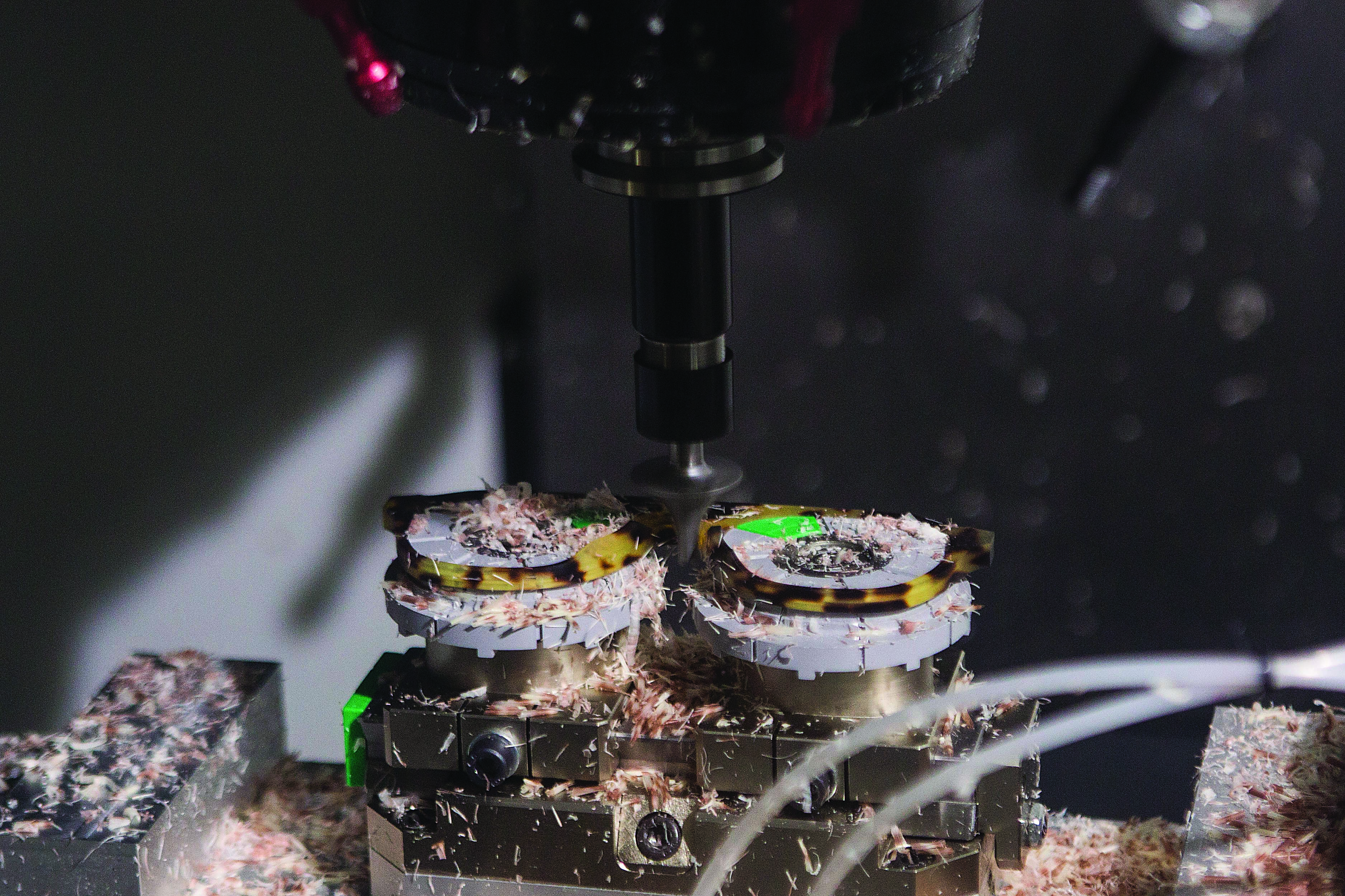

Lowercase machines an acetate eyewear frame. Image courtesy of Lowercase.

To machine the frames, Lowercase mounted two custom vises onto a rotary indexer in the machine. The robot picks up the raw material and loads it into the vise that clamps along the part’s outside edges so the machine can cut the shapes of the lenses and their grooves, closes the door and presses the “go” button. It then removes the part, the indexer flips over, the robot places the part in the second vise, which has two lens-shaped discs that expand to hold the part from inside the frame, and the machine cuts the exterior profile. The robot then removes the finished part and places it in a bucket.
