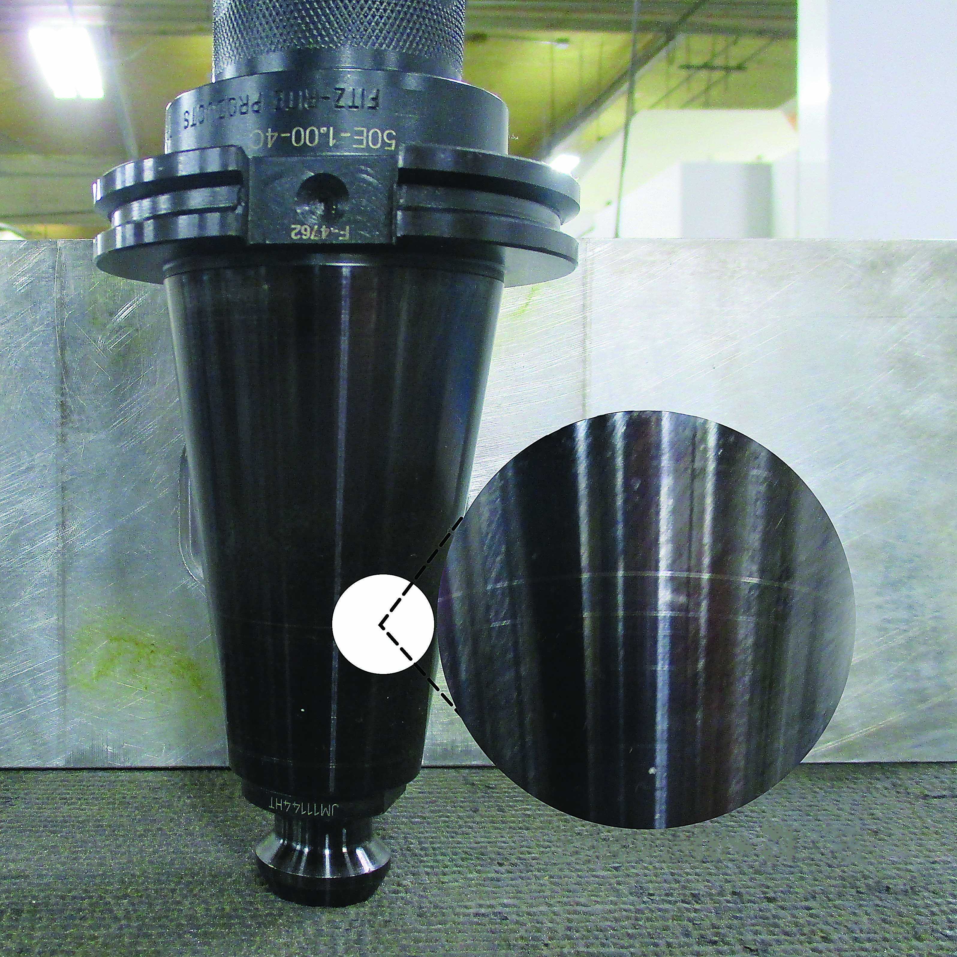

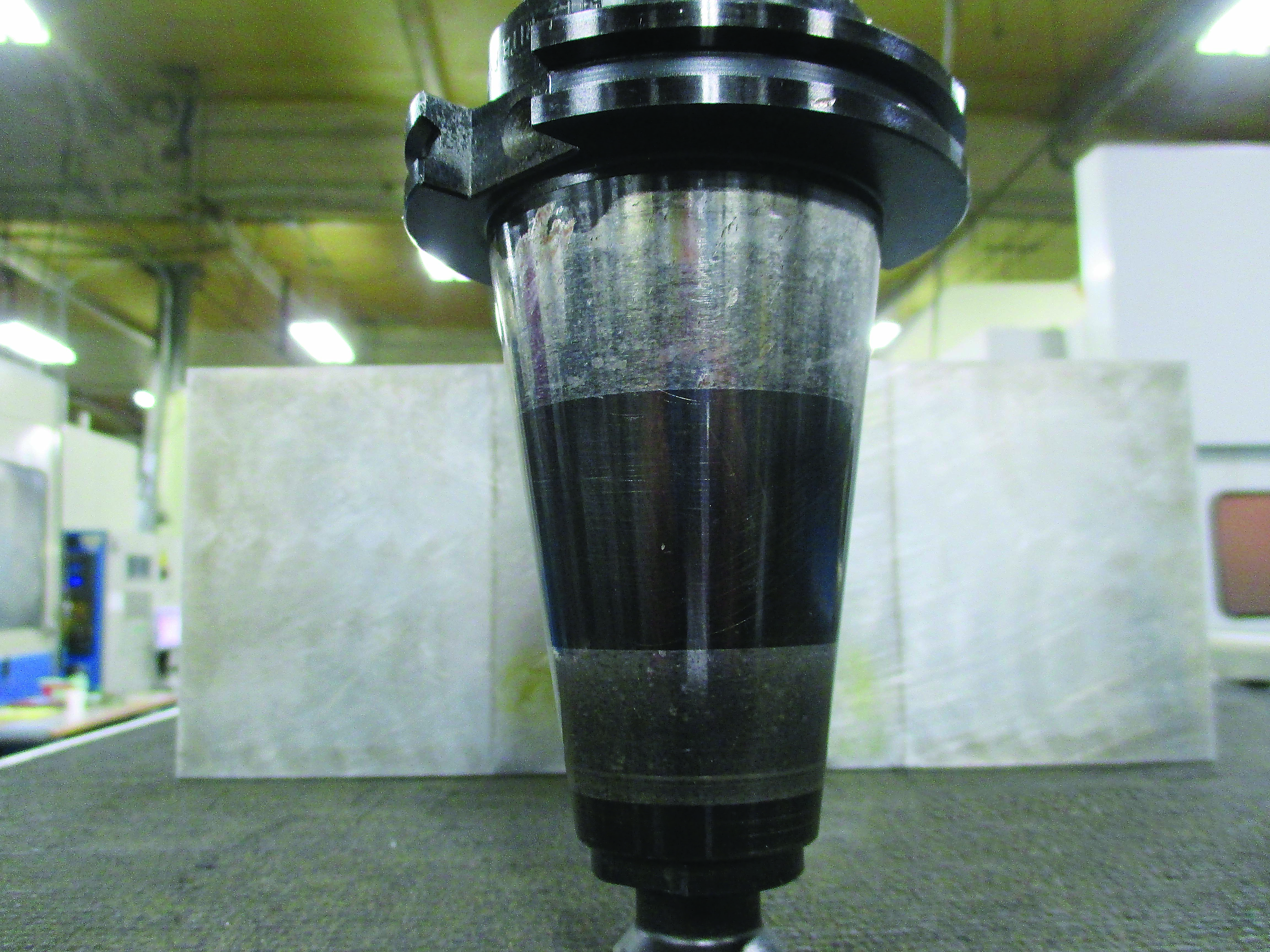

Far Left: With a standard retention knob, taper deformation on the toolholder prevents it from properly mating
with a CNC machine tool’s spindle. Left: The high-torque retention knob from JM Performance Products enables
a toolholder to have close to 100 percent contact with the spindle. Image courtesy of Hansen Engineering
Over time, heavy-duty machining jobs began to present issues. Toolholders were getting stuck in the spindle because of deformation, evidenced by wear marks at the top and bottom of the holders. Fretting appeared on contact surfaces and increasingly long cycle times developed. These problems led to more production shutdowns to allow the machines to cool off for significant periods of time. In addition, chatter and the resulting poor surfaces were recurring when roughing titanium, stainless steel and aluminum.
Seeking a solution, HEC engineering personnel attended a trade show where they saw JM Performance Products, Fairport Harbor, Ohio, demonstrate the benefits of JMPP’s high-torque retention knobs. These knobs are longer and reach deeper into the holder’s threaded bore than a standard knob, JMPP reports. Relief located below the flange forces threads—which are cut to start and finish 180° from each other—into a deeper cross-section of the toolholder. As a result, all thread engagement occurs in a region of the toolholder where there is a thicker cross-section of material to resist deformation.
Intrigued by their potential, HEC initially purchased 25 high-torque retention knobs. They properly installed the knobs in some of their existing toolholders by following calculated torque specifications and using a retention-knob socket and torque wrench. The parts manufacturer immediately saw a 5 percent decrease in the spindle load when cutting titanium with a 3″ (76.2mm) high-feed, indexable-insert milling tool.
