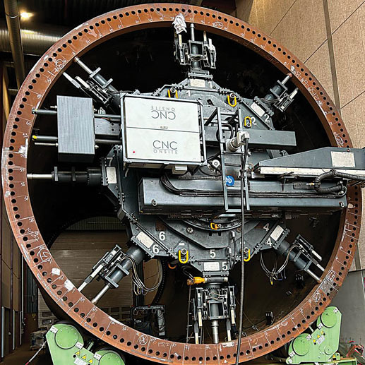

CNC Onsite A/S in Vejle, Denmark, has delivered its custom-built Goliath machine tool to wind tower manufacturer Welcon A/S in Give, Denmark. Welcon is milling 97 bottom tower flanges for 15mW V236 turbines for projects in Germany and the Netherlands. Production began in April 2025, and the first flanges have already exceeded flatness specifications, ensuring a precise fit with the transition piece — enhancing reliability and design flexibility and significantly reducing costly post-production checks.
The milling process ensures that the tower and transition piece align, forming a flat, stable connection between the two flanges, a critical mechanical joint held together with bolts. By implementing CNC Onsite’s machining process, tight tolerances are achieved, which eliminates the need for heat straightening, a common post-production step to correct flatness issues, while also optimizing the maintenance of bolts during operation.
Heat straightening is a method used to correct distortions in metal components, such as wind turbine flanges, caused by manufacturing, welding or operational stresses. The process involves applying controlled heat to specific areas, causing the metal to expand. Once cooled down, it contracts, helping to restore the component’s original shape.
CNC Onsite specifically designed Goliath to ensure flat flanges for structural strength and fatigue resistance.
“On the first flange, we have achieved a global flatness tolerance of 0.21 mm. The required 1 mm for this project is already well below the common industry standard of 2.5 mm, so we are, of course, very pleased with the machine’s performance,” said Soren Kellenberger, sales director and partner at CNC Onsite. “Ensuring a tolerance of 1 mm or better is a significant benefit when it comes to ensuring correct bolt tightening. With 160 bolts in a flange, reducing maintenance costs and downtime due to loose bolts is a considerable cost saver.”
Image of Goliath machine
The first flange milled on the Goliath machine from CNC Onsite achieved a tolerance of 0.21 mm (0.008″). CNC Onsite

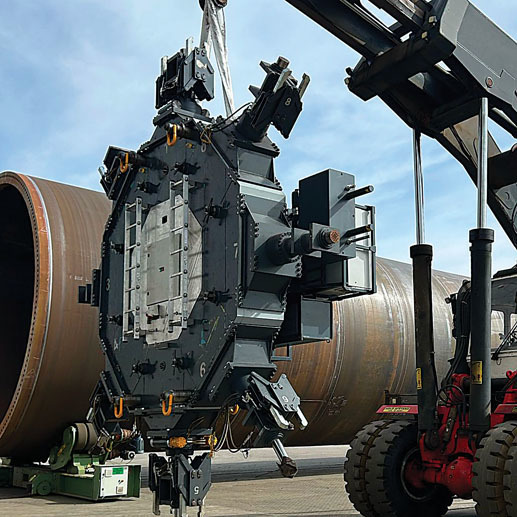

CNC Onsite’s Goliath machine tool prior to being mounted onto the flange. CNC Onsite

Goliath is mounted directly onto the flange, according to CNC Onsite. Using adjustable legs with hydraulic cylinders or optional electric actuators, the machine is securely positioned, allowing easy switching between different flange diameters.
The machine, which is equipped with powerful electric motors to enable fast, high-precision milling, is capable of handling flanges from 6.5 m to 10 m (19.7′ to 32.8′) in diameter in the standard configuration and can be adapted for larger sizes.
Goliath also can mill flat, tilted and double-tilted flanges, as well as features like gasket grooves.
