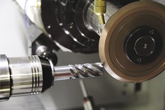

The Walter Helitronic Vision grinding machine produces rotationally symmetrical tools and parts with complex geometries. Image courtesy United Grinding North America.

“The machine tool is not going to be the problem,” added United Grinding’s Ehrlich. “All toolmakers have 5- or 6-axis machines that can interpolate the most complex geometry you can think of. The real questions are, does the software possess the ability to process that kind of geometry, and can you produce the tools consistently?”

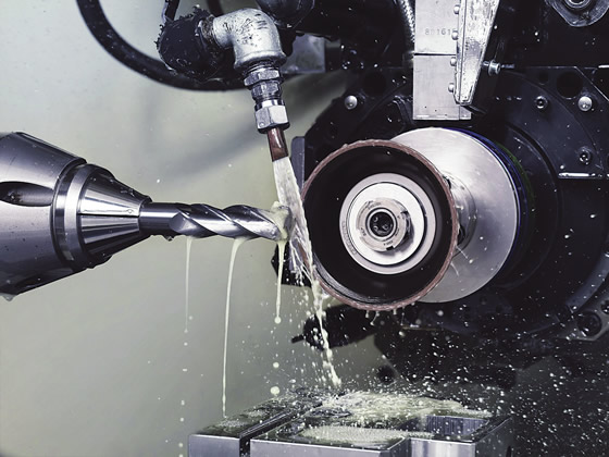

Radiac says its STARTEC XP-P abrasive reduces cycle times when grinding the flutes of round tools through effective profile retention, minimized tool deflection and reduced machine load. Image courtesy Radiac Abrasives.
United Grinding’s tool grinding machines utilize proprietary grinding software, which imports CAD drawings and feeds toolpaths to the machine. According to the company, what sets its software apart is specially developed correction software called FTC (Form Tool Compensation), which feeds data from the company’s Helicheck CNC measuring machines into the grinding machine’s CNC.
“If there are any deviances in the tool profile beyond a certain, predetermined tolerance, the Helicheck will correct the shape of the profile, and FTC will send that corrected shape to the grinder,” he explained. “A CNC grinder can usually be accurate to ±10µm; if we are checking regularly, we not only can account for variables like wheel wear, we can reduce that tolerance to ±3µm.”

Grinding wheels, of course, are a key part of making complex tools. “Obviously, you want a grinding wheel that is going to have good form-holding qualities, good mrr and be well balanced with excellent axial and radial runout.” said John Guenther, business unit manager–cutting tools for Radiac Abrasives, Oswego, Ill. “That means the tool you’re making plays a part. A small-diameter tool will be more vulnerable to pressure from the grinding wheel, so you won’t be able to really push the wheel the way you might on a large tool. Larger tools are a bit more forgiving, so you can shoot for a higher mrr.”
Wheel selection, added Rush’s Freese, also involves the tool geometry and determining the proper grit size, core material and bond.
“When you’re working with complex profiles, the grinding wheel itself becomes critical,” he said. “You are trying to hold a lot of tolerances in a lot of areas, and the more complicated the geometry, the more those come into play. We supply the machines for dressing and truing the wheels to do the job, because more complex geometries can require a more complex shape on the wheel itself.

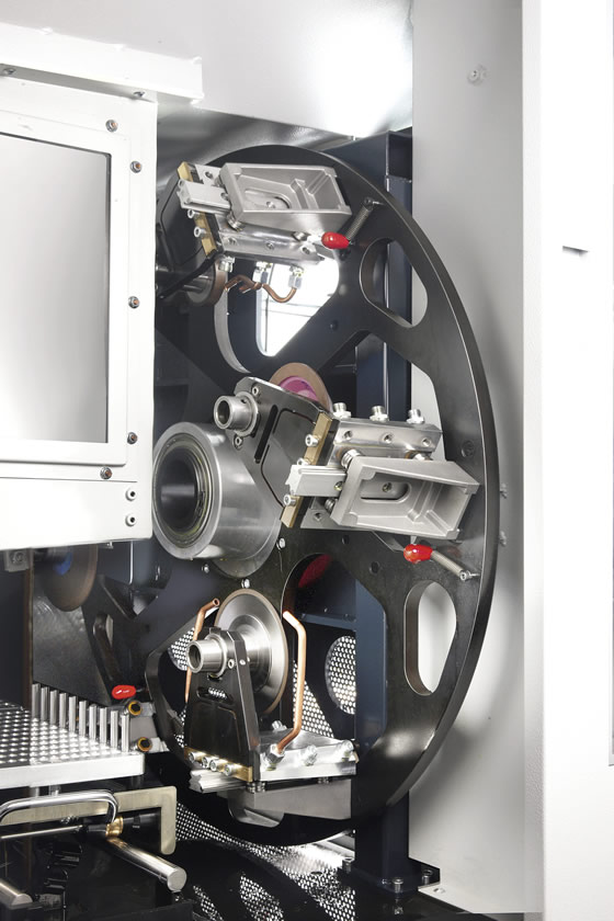

Reinecker’s WZS-700 tool grinder comes with an automatic wheel changer, allowing peel and profile grinding in a single setup. Reinecker Tool Grinders.

Reinecker’s Holubeck pointed out that, in addition to manufacturing dedicated peel grinders, the company’s WZS 700 tool grinder comes with a wheel changer, allowing customers to perform peel and profile grinding in a single setup.
“The biggest bottleneck on a standard tool and cutter machine is getting the blank prepared,” he said. “There are already many steps required to make the tool, and it takes a lot of additional work to blank out the diameter. Good blank preparation can greatly reduce the amount of time spent on the tool and cutter grinder.”
