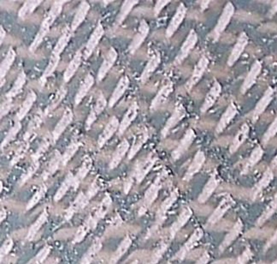

Figure 1. A scraped surface with blue marking compound. The blue spots mark small depressions that will contain oil.

Plain sliding guide ways do not require an external power source. The sliding element and stationary element are typically cast iron, and their surfaces are closely matched geometrically, but they are not perfectly smooth. A thin film of oil separates the two surfaces. It is retained in small, randomly dispersed depressions on the surfaces that act as oil reservoirs.
The reservoirs are replenished by occasionally squirting a little oil on the way in front of the sliding element. The oil is pulled by the motion of the sliding element from the reservoirs into the space between the contacting points of the two surfaces. This effect forms a hydrodynamic bearing, and the oil film is created and maintained by the motion. The critical features in the bearing are the close fit of the geometric form between the stationary and moving surfaces, and the surface texture. Unlike the other guide ways discussed above, the features on plain guide ways are obtained by hand scraping.
Scraping is one of the oldest and most historically significant metal-removal processes. It can be used to make accurate straight edges without the need of an external reference, and it is the basic metal-removal technique for making machine tools. Cast iron can be easily scraped, because it contains many graphite flakes in its structure. Small amounts of metal are removed from cast iron with a sharp blade, much like scraping paint off of a window.
The machine builder decides where to scrape by first painting the two surfaces to be matched with a thin coat of a marking compound, typically blue pigment mixed with a nondrying fluid, such as oil. The moving element slides along the stationary element for about 1 “, then the elements are separated. Contact that occurs between the elements removes the marking compound, and the compound left behind on the surface marks the low spots (see Figure 1 above).
If the surfaces have large a large geometrical form mismatch, there will be large contiguous shiny areas. A scraping tool, essentially a large, sharp, flexible blade on a handle, is used to remove small layers of metal from the shiny spots. This procedure is repeated many times on this section of the guide way, and many more times along its length. As the form of the moving element and the guide way are brought closer together, the blue spots become smaller and more randomly distributed. The goal is to eventually carry the load across a large bearing area and to create many small, randomly distributed depressions to hold the oil. Most scrapers try to make 10 to 40 small pockets per sq. in. Hand scraping of guide ways is a craft and it takes extensive training to become an efficient scraper.
A typical goal is to have 50 to 60 percent of the bearing area in contact with the way. If there is less contact area, the bearing will wear quickly, or the oil will not be pulled into the gaps. If there is a larger contact area, the reservoirs are insufficient to retain the oil, the bearing will be starved of lubrication, and the two surfaces will stick, like the wringing of gage blocks.
