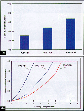

After comparing the properties of the three PVD coatings, the researchers conducted metalcutting tests on the three workpiece materials. Figure 2a shows tool life for identical carbide substrates coated with TiN, TiCN, and TiAlN in the turning of Inconel 718. At cutting speeds of 46m/min. and 76m/min., TiCN- and TiAlN-coated tools performed significantly better than TiN-coated tools. The end of tool life for all three coated tools was dictated by maximum flank wear and nose wear. Figure 2b plots maximum flank wear as a function of time at a cutting speed of 46m/min. The researchers noted the excellent resistance to maximum flank wear of the TiAlN-coated tools.
Not only did the TiAlN-coated tools show the lowest maximum flank wear, but they exhibited lower nose wear and crater wear than tools coated with TiN and TiCN. The researchers examined the used edges of the TiN-, TiCN-, and TiAlN-coated inserts after 5 minutes of cutting at 46m/min. Although the TiAlN-coated tools showed a tendency for DOC notching, the end of tool life was reached by maximum flank wear.
| Figure 2: Metalcutting test results (a) for the wet turning of Inconel 718 at speeds of 46m/min. and 76m/min., a feed rate of 0.15mm/rev., and a DOC of 1.50mm; wear curves (b) at the slower speed. |

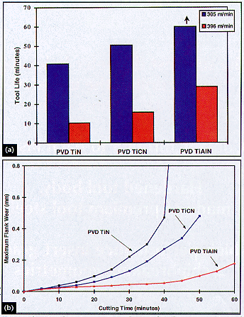

Figure 3a shows tool life for the three PVD-coated tools in the turning of SAE 1045 at speeds of 305m/min. and 396m/ min. Again, the TiCN- and TiAlN-coated tools lasted longer. At 305m/ min., the tool life of TiAlN-coated tools exceeded 60 minutes and the test was terminated. Figure 3b plots maximum flank wear as a function of cutting time at 305m/min. As in the case of Inconel 718, the superior wear resistance of TiAlN relative to TiN and TiCN was apparent.
The researchers then examined the used edges of the tools after 15 minutes of cutting medium-carbon steel at 305m/min. They noted the excellent crater-wear resistance of the TiAlN-coated tools relative to the TiN- or TiCN-coated tools.
| Figure 3: Metalcutting test results (a) for the wet turning of medium-carbon steel at speeds of 305m/min. and 396m/ min., a feed rate of 0.15mm/rev., and a DOC of 0.76mm; wear curves (b) at the slower speed. | ![]() |

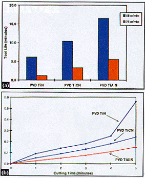

Figure 4a shows tool life for TiN-, TiCN-, and TiAlN-coated tools in the turning of ductile cast iron at 244m/min. Again, the TiAlN-coated tools had the longest tool life, followed by the TiN- and TiCN-coated tools. Figure 4b presents maximum flank wear as a function of cutting time. The researchers noted the improved flank-wear resistance of TiCN and TiAlN compared to TiN.
An examination of the used tool edges after 2 minutes of cutting ductile cast iron revealed results similar to those for medium-carbon steel. The TiN- and TiCN-coated tools showed more crater wear than the TiAlN-coated tools.
| Figure 4: Metalcutting test results (a) and wear curves (b) for the wet turning of ductile cast iron at a speed of 244m/min., a feed rate of 0.15mm/rev., and a DOC of 1.50mm. | ![]() |
