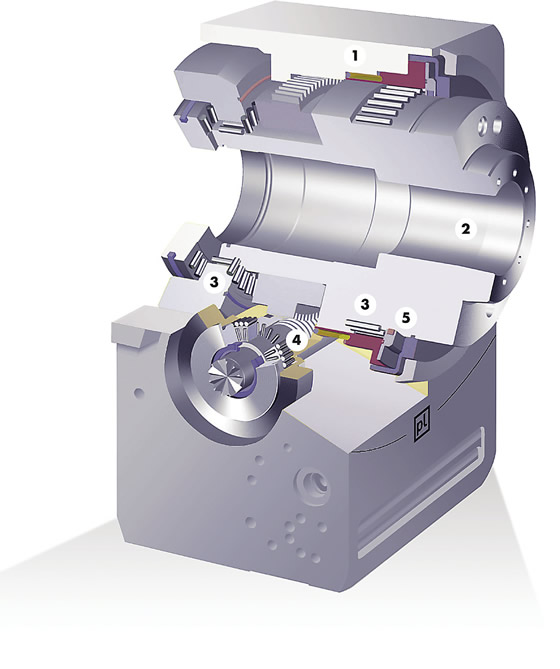

Cutaway of a Lehmann rotary table: 1) The clamping ring applies 360° equal clamping force on the rotary axis; 2) the rotary axis; 3) the preloaded radial and axial needle bearings; 4) the gear train; and 5) the standard spindle seal, which can be extended with a labyrinth seal for high-pressure coolant application.

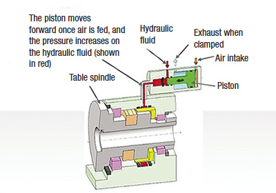

Pressure also comes into play when selecting the appropriate braking system for a rotary table. According to HPI- Pioneer’s Flick, two basic variations exist: a disc brake system and a hydraulic version that provides higher braking pressure than a disc brake. Although hydraulic systems are prevalent, he pointed out that the company offers models with the less-typical air-over-hydraulic booster inside the table’s motor cover, eliminating the need for a hydraulic pump or other external hydraulic supply. Instead, 70-psi shop air does the trick. This is because the table clamp mounted inside the air-hydro structure boosts the hydraulic pressure and achieves higher clamping power simply by providing air pressure. (See image below.)
“The higher the braking pressure, the more aggressive machining you can perform on the rotary table,” Flick said. “Hydraulic boosters are becoming more common because people want to machine harder and harder on the table.”
He added that there’s no angular pressure on any braking system when using a rotary table to cut on-center, but the type of system makes a significant difference when machining off-center because the pressure created on the cutting location increases based on its distance from the center. Hydraulic systems permit more aggressive cuts, even when machining farther out on the table.
The heavy-duty, zero-backlash braking systems on the rotary tables from ITI Tooling can use hydraulic pressure up to 870 psi, according to Bickham, but 580 psi is more typical. In addition, the tables can use an air supply together with an air-over-oil intensifier, which provides benefits because shop air is generally more readily available and is restricted to a safer pressure than a hydraulic system. Bickham added that whether it’s an air- or a hydraulic-actuated brake, the brake operates in the same manner by expanding a 360° pressurized sleeve that wraps around the table’s center axle, holding it rigidly in place.
Cost considerations can play a prominent role when selecting a rotary table’s braking system. The disc brake is the most popular type because repairs are fairly inexpensive, according to CNC Indexing’s Schwarz. The repair is usually performed on tables 10 years and older used for heavy machining, he said. “We can get the repair done within a day for a few hundred dollars.”
air-hydr%20booster%20brake%20system.tif
With the air-over-hydraulic brake system in Yukiwa’s rotary tables, the increased hydraulic pressure can achieve stronger clamping power by providing air pressure.

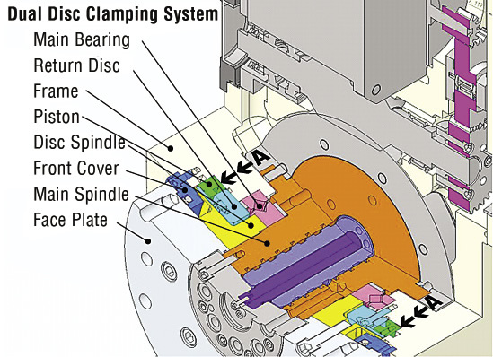

Arnestad indicated that Koma offers several braking system options. Called the RNE series table, the pneumatic, dual-disc system is the most economical, while offering good accuracy and a good torque drive, he noted. The mid-range RNA series table has a dual-taper clamping system that uses a pressure intensifier, where a ring of ball bearings are captured between the clamping ring and the piston.
“The piston has an angular feature on it, as well as an angled member inside the braking system so, as the piston moves forward, it displaces that ring of ball bearings and triples the clamping force,” Arnestad said. This enables taking heavier off-center cuts without the fear of the rotary faceplate turning under force.
Arnestad added that the hydraulic, dual-disc clamping system, called the RBA series table, is the company’s most robust. “That’s targeted for high-volume production,” he said, “where they need to hold very close tolerances and want to machine at the fastest rate possible.”

According to Rotec’s Straessle, Leh-mann rotary tables have the same braking system for any application, using a built-in air-over-oil intensifier. This booster coverts 90-psi shop air into more than 4,000 psi of hydraulic pressure, he added, and a clamping ring equally applies 360° clamping force to the rotary axis. “A high clamping force allows high feed rates and high workpiece accuracy.”

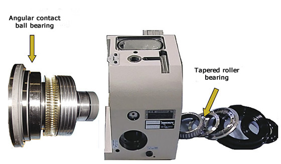

Bearing Down

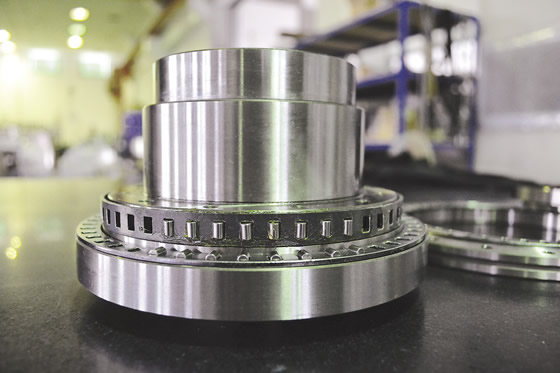

End users can also increase machining parameters when a rotary table’s bearing configuration enhances table rigidity. For example, preloaded axial and radial needle bearings in front of the table next to the spindle nose and preloaded axial needle bearings in the rear of the spindle (all inside the gear housing) provide a high level of rigidity, Straessle explained. Preloading eliminates the undesirable “give” for the bearings in the axial and radial directions. “This design allows the customer to work with heavy workpieces and, at the same time, reduces overall vibration,” he said.

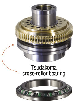

According to Arnestad, a cross-roller bearing construction provides the best rotary table support. “It gives better stiffness and less runout than, say, tapered roller bearings, which have a chance of losing their preload over time,” he said.
PIONEER-YUKIW-IMTS%202008.tif
Courtesy of HPI-Pioneer
Yukiwa rotary tables from HPI-Pioneer have a dual-bearing system, where two sets of bearings at both ends of the body provide triple-contact support and the largest angular contact bearing is underneath the table face to enhance bearing support.
In terms of runout, HPI-Pioneer’s Kiriyama noted the bearings in Yukiwa’s rotary tables provide a 0.0001″ runout and are the same grade as the ones machine tool builders use for their spindles. According to the company, the tables have a dual-bearing system, where two sets of bearings at both ends of the body provide triple-contact support, and the largest angular contact bearing is underneath the table face to maximize bearing support.
The alternative to a dual-bearing system is a single-row, center-bearing design, where, as the name implies, one row of bearings is in the center of the spindle. This design tends to enable more spindle tipping, or leaning, but HPI-Pioneer’s Flick noted it can be engineered to provide the required support.

This cutaway of a rotary table shows the components in Tsudakoma’s hydraulic dual-disc clamping system.
HPI-Pioneer repairs and replaces worn bearings from its rotary tables, as well as from its competitors. “A good table will go 5 to 10 years before it needs work, just like a machine,” Flick said. “With a low-end table, you’re doing it annually. It’s that dramatic of a difference.”
After L.C.M. purchases ultrahigh-grade bearings, the company frequently reworks the new bearing assemblies to reduce the runout and improve the load-carrying capacity, ITI Tooling’s Bickham pointed out.
Similar to a braking system, a high-quality bearing configuration effectively supports the workpiece load and machining pressure in the axial and radial directions. This proves beneficial when machining on a rotary table that’s not adequately matched to the application. “Everyone wants to buy the least expensive table they can and push it to its limits rather than going the next size up,” said CNC Indexing’s Schwarz.

1CROSS%20ROLLER%20bearing.tif
Courtesy of Koma Precision
A cross-roller bearing construction in Tsudakoma rotary tables enhances support, according to the company.
