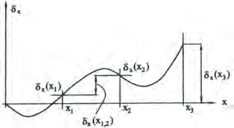

Chart courtesy of “Manufacturing Processes and Equipment,” by George Tlusty, Prentice Hall
Figure 1. Idealized linear positioning error in the direction of X-axis motion. The error is a function of axis position.

To start, there are three linear positioning errors, one for each axis. In a machine with ballscrew drives, the ballscrews are not perfectly fabricated. As the screw rotates and the nut slides, the carriage moves a little more or a little less than planned. These linear positioning errors are denoted δx(X), δy(Y) and δz(Z), where the letter in the parenthesis indicates which axis is moving, the subscript indicates in which direction the error is measured and the symbol δ indicates a linear error, as opposed to rotational one. In addition, guide ways are not perfectly straight or attached to the machine frame. For any axis motion, there are six errors perpendicular to that motion. They are denoted δy(X), δz(X), δx(Y), δz(Y), δx(Z) and δy(Z). That makes nine error terms so far.

Each error term is not a number, but rather a function of the position of the moving axis (Figure 1). In this simplified case, the gage was set to zero when the X-axis position was zero. As the X-axis moved, the X-axis position was measured and plotted. A positive error indicates the axis moved too far, and a negative error indicates the machine moved too little.
