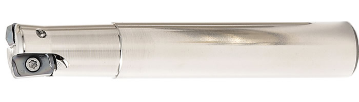

RJ Enterprises requested assistance from Hendersonville, N.C.-headquartered Kyocera Precision Tools Inc. The toolmaker recommended its 58“-dia. (15.875mm), 3-flute MFH-Mini Raptor endmill tooled with its PR1535 inserts. The PVD-coated, double-sided inserts have four cutting edges.

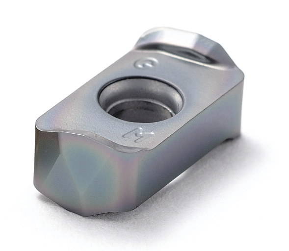

Kyocera’s Raptor-Mini endmill accepts the toolmaker’s PR1535 double-sided inserts (below), which have four cutting edges. Images courtesy Kyocera Precision Tools.

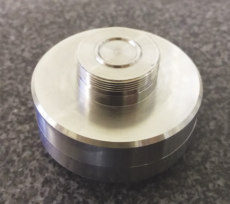

Scott Pettay, field sales engineer for Kyocera, noted RJ Enterprises was able to switch to a larger endmill because the tool is for machining the part OD. He added that Akrabian initially thought he would have to apply an endmill smaller than ½” in diameter to reduce tool pressure.

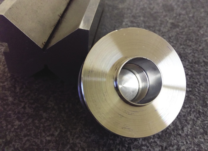

With the indexable-insert endmill, RJ Enterprises now roughs at a cutting speed of 250 sfm (76.2 m/min.), a feed rate of 90 ipm (2,286 mm/min.) and a DOC of 0.020″ (0.508mm). Although the indexable tool runs at a slower speed and takes a smaller DOC than the solid-carbide tool it replaced, Akrabian emphasized the productivity gains made possible by the six-fold increase in the feed rate: “We gave up the depth of cut, but we went from 15 ipm to 90 ipm. It’s smoking! I was hoping to cut the cycle time in half, but it went from an hour to 22 minutes for six parts.”
In addition, one cutting edge lasts for 12 parts, and a box of 10 inserts, which provides 40 cutting edges, costs about $80 compared to the approximate $50 price tag for the carbide endmill, Akrabian said. “It was a cost savings, overall.”
The company still finishes the part using a solid-carbide endmill, removing 0.010″ to 0.015″ (0.254mm to 0.381mm) of material, he added.
Pettay pointed out that the PR1535 insert offers versatility because it is suitable for milling stainless steel, titanium and Inconel. In addition to 304 stainless, Akrabian said RJ Enterprises uses it for cutting 420 stainless.

The 304 stainless fuel sensor before the roughing operation. Image courtesy RJ Enterprises.
The 304 stainless fuel sensor before (above) and after (below) the roughing operation. Images courtesy RJ Enterprises.
The 304 stainless fuel sensor after the roughing operation. Image courtesy RJ Enterprises.
