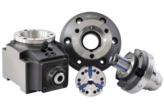

PARTsolutions strategic parts management software from Cadenas reduces unnecessary parts and increases revenue and productivity at Röhm, which produces workholding clamps and chucks.
