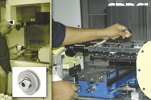

Dharmdeo Sookhai, foreman for SDP/SI’s CNC milling department, with the company’s DuraVertical 5100 5-axis VMC from DMG / Mori Seiki USA.
Courtesy of SDP/SI
SDP/SI machines the Fairloc hub on its DuraVertical 5100 VMC.

Another suitable part for that machine is SDP/SI’s Fairloc hub, which requires a countersink, drilled clearance hole, tapped hole and two angular cuts. The DuraVertical 5100 produces the part in one setup. The company machines eight hubs per fixture, and Sookhai noted that VMC machines a fixture of parts in 7 minutes compared to 9 minutes on the previous machine. “We do these parts by the thousands [annually],” he said.

The number of different parts the 5-axis milling machine can create is vast, thanks in part to SDP/SI’s inventory of more than 500 custom fixtures that it produced in-house, Zeisler explained. Not only do the fixtures support large quantities in a single run, a new fixture is not required if a similar part needs to be machined. This is because the fixture already in place can be adjusted to make the required changes to hold the part.
“We just have to do minor changes on a fixture, like changing the pin for a different bore and adjusting the jackscrew up or down,” Sookhai said.
