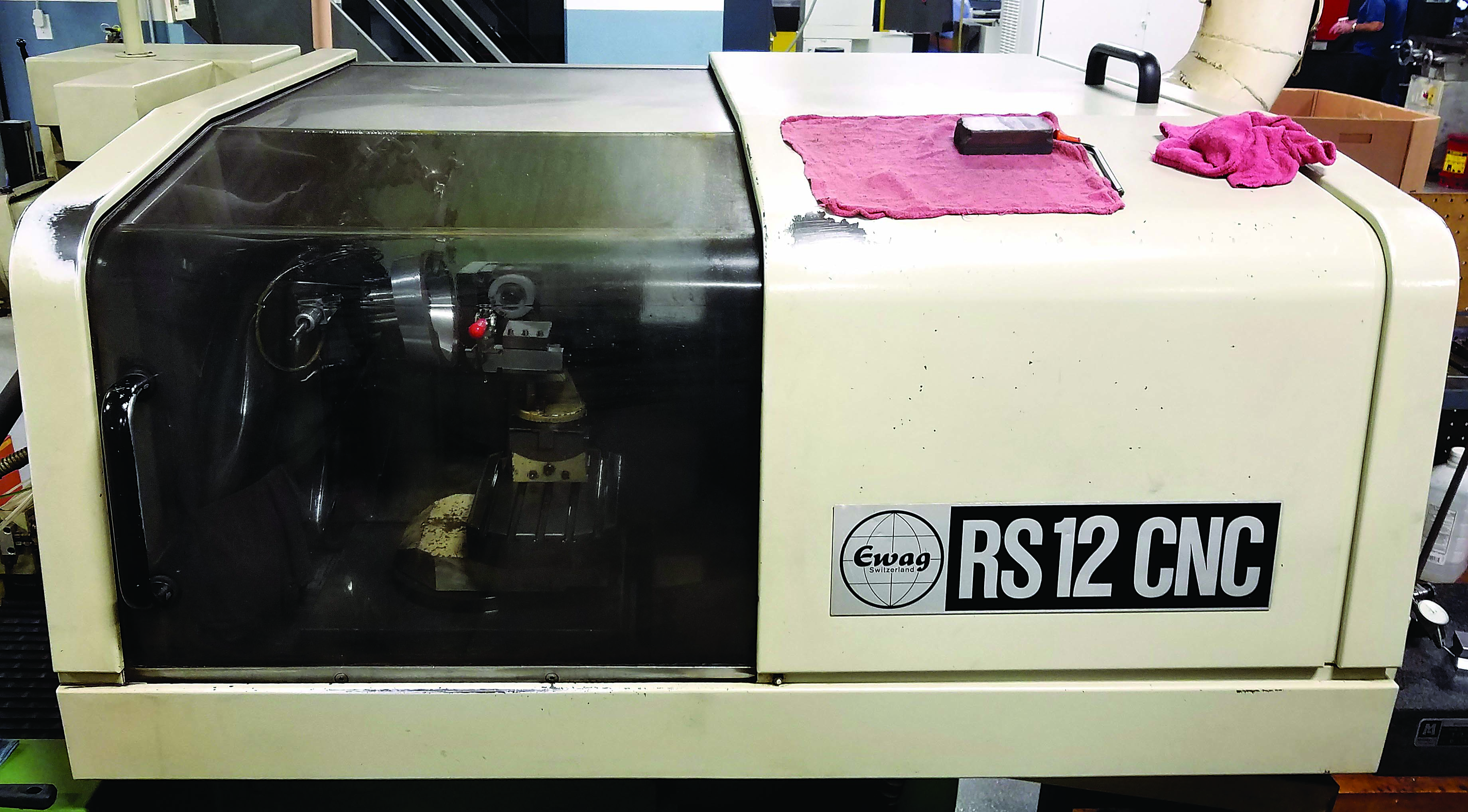

The five-axis Ewag RS12 insert grinder is shown prior to being retrofitted. Image courtesy of Num

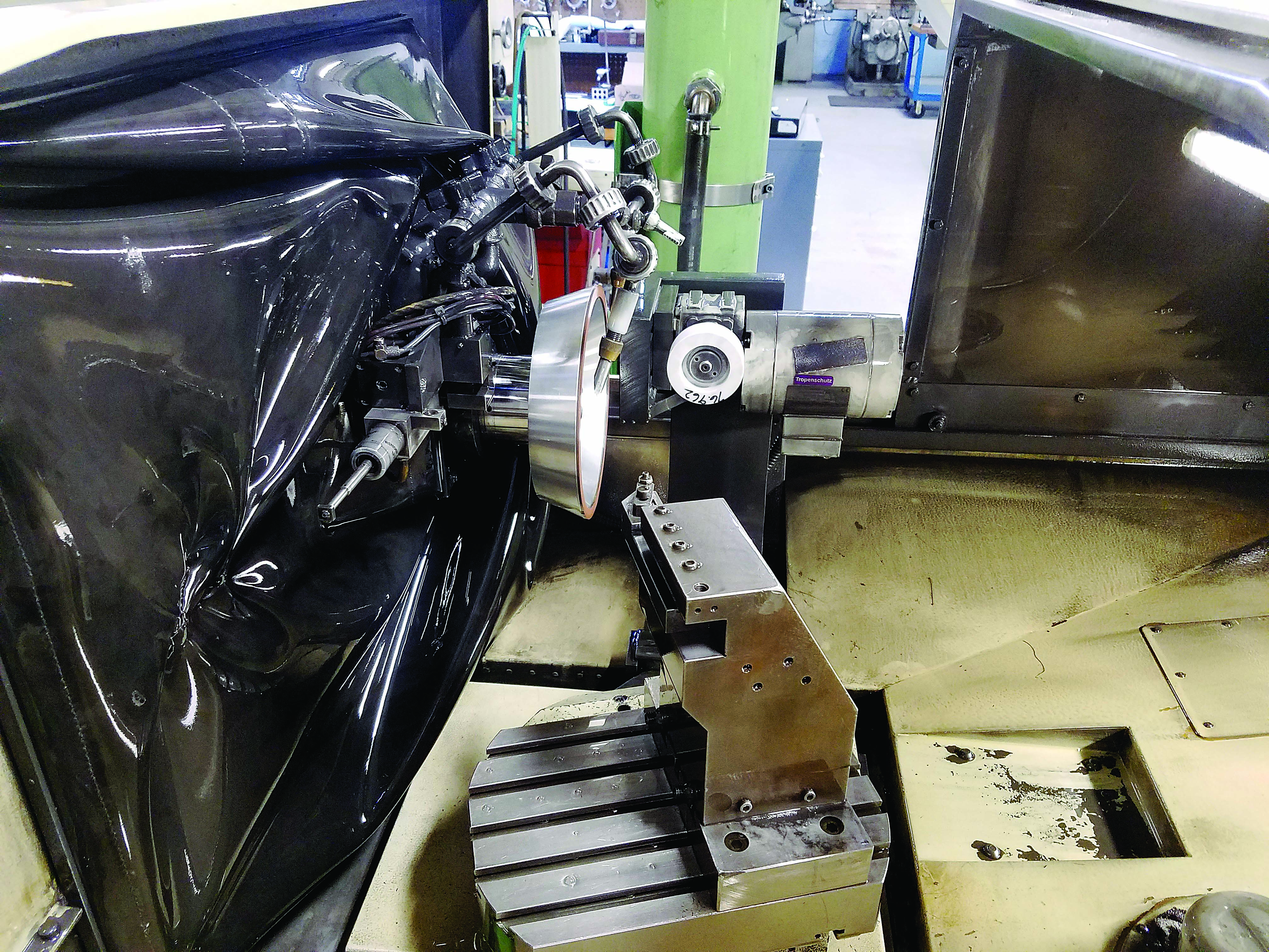

The RS12 grinder is displayed after the upgrade. Image courtesy of Num
