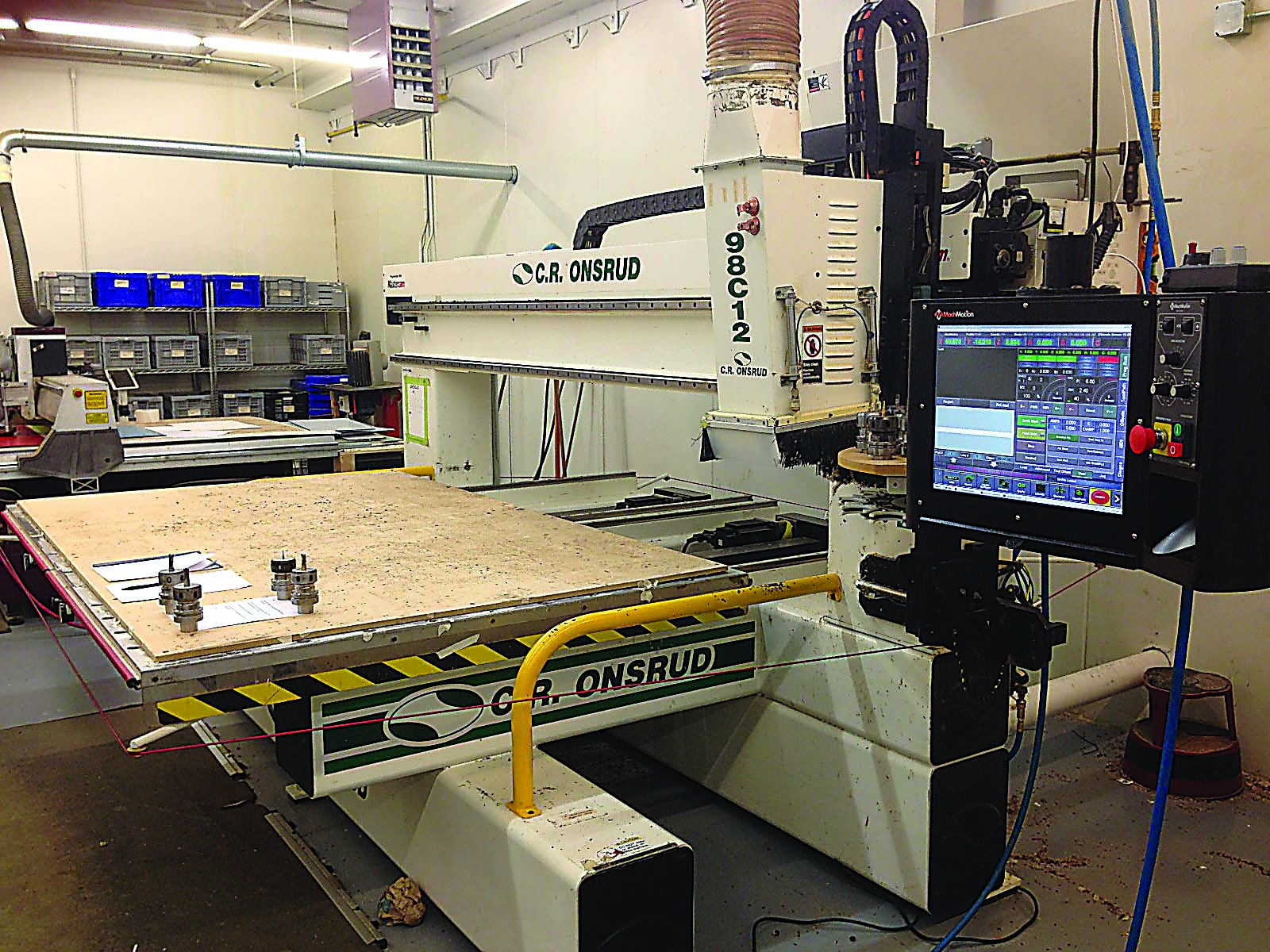

CNC routers, waterjets and plasma tables are just a few of the machine types suitable for retrofitting. Image courtesy of MachMotion

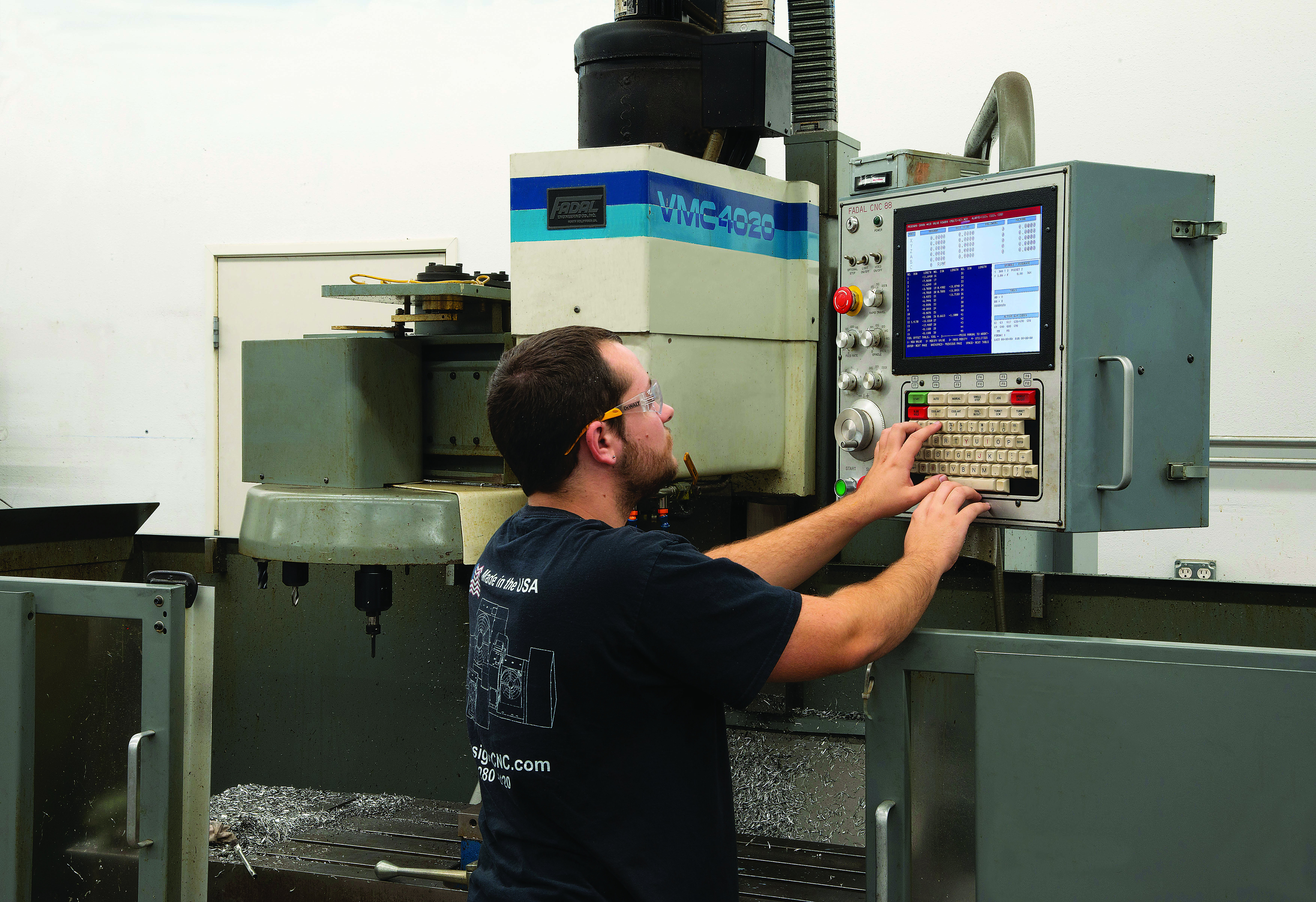

No matter how old the Fadal, Calmotion has a way to make the control and electronics new again. Image courtesy of Calmotion

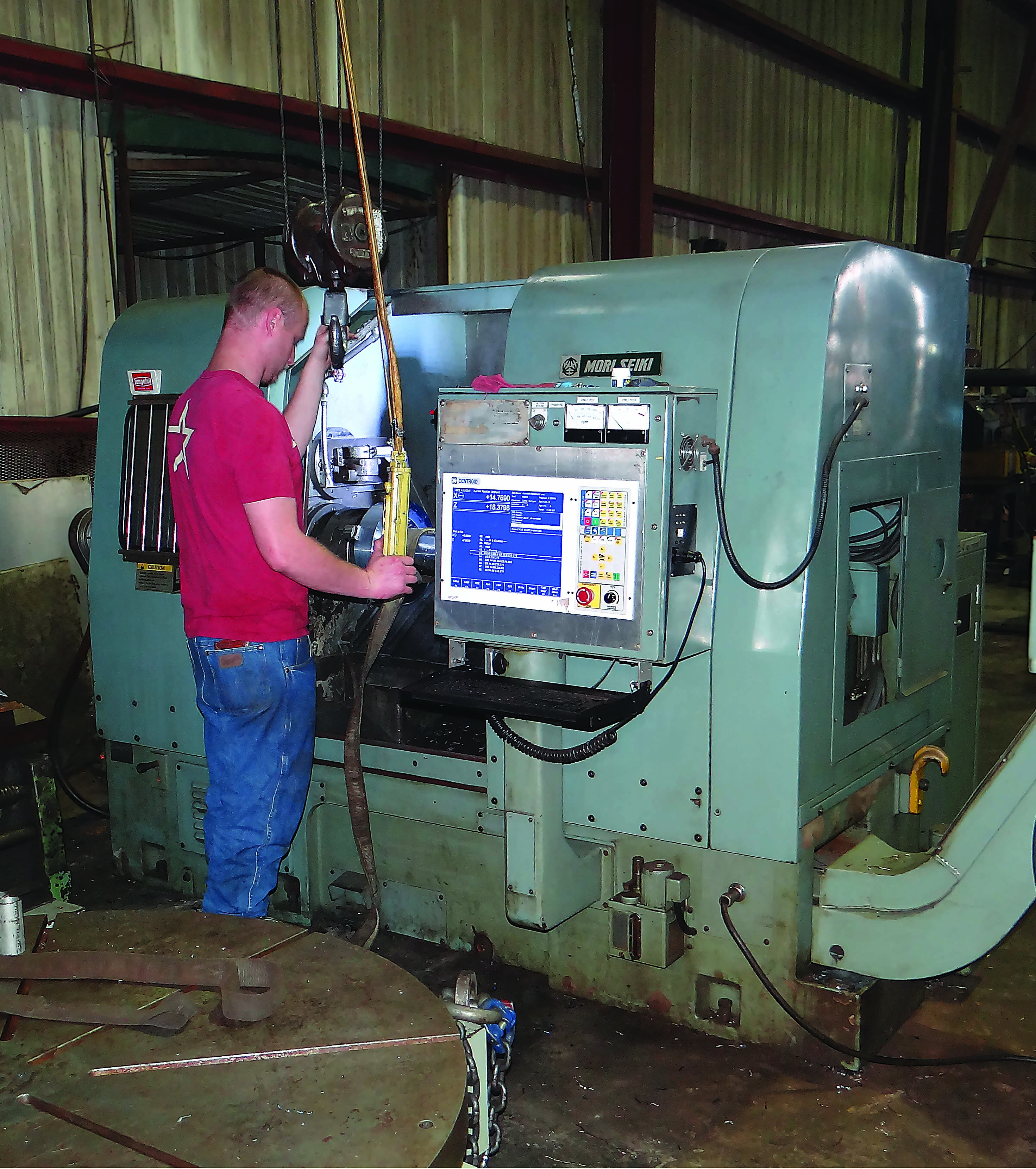

Control retrofits are a great way to bring mechanically sound CNC machines up to speed quickly. Image courtesy of Centroid
