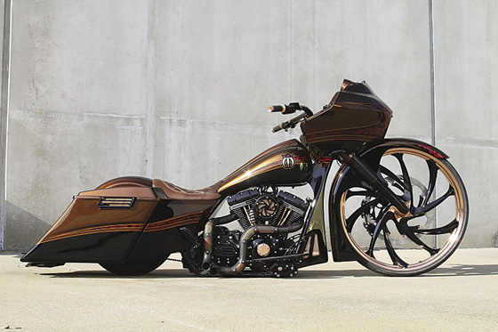

Brennivin bags from Misfit Industries are installed on a Sick CVO motorcycle. Below: A 3D rendering shows Misfit Industries’ Brennivin Real Steel saddlebag kit.
