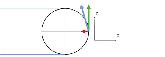

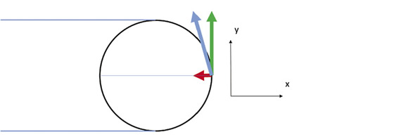

If a drill does not run concentric to its centerline, higher forces are generated in the radial direction of the highest margin, causing more wear on one side.

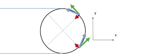

BIG Daishowa ran similar tests to calculate values for a 4-flute, 10mm-dia. carbide endmill (Figure 3 on page 62). Cutting length increased from 528 ‘ to 693 ‘, 1.3 times longer, as runout decreased from 0.0006 ” to 0.00008 “. The reason is clear: With runout of only 0.00008 “, the cutting forces are evenly distributed on each flute, whereas with runout of 0.0006 “, an excessive force will be applied to only one flute. Less runout helps stabilize the cutting depth on each flute and produces a finer surface finish.
