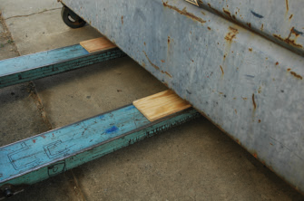

When operating a forklift, always place a piece of wood between each fork blade and the object being moved.

Whenever you have to move a piece of material or heavy equipment with a forklift that has a metal bottom, always put a piece of wood between each fork blade and the object. All you need is a thin piece of plywood, which acts like a brake shoe and keeps the load in position.
The oily bottoms of machine tools are a good example of metal on metal as a low-friction bearing surface. A metal-on-metal moving scenario can cause the load to shift dangerously. Many forklift drivers have experienced a long piece of bar stock pivoting, as if on bearings, on the fork blades during a small turn. Uncontrolled loads are just that—uncontrolled.
